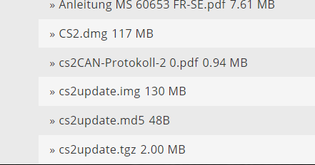

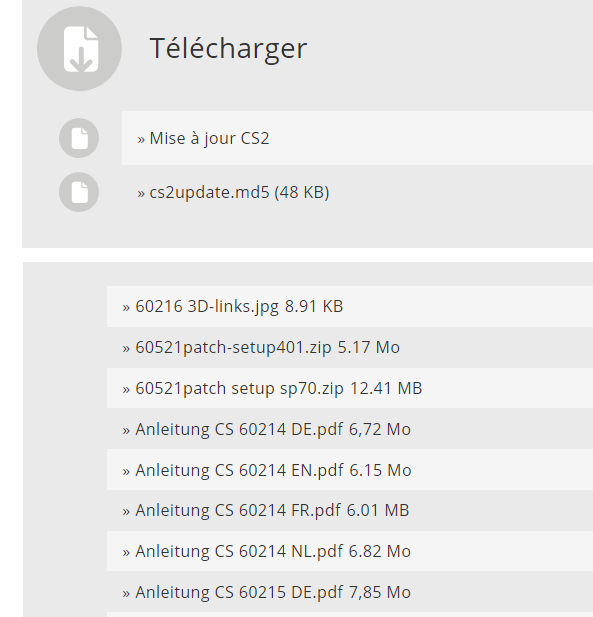

I tried to update the v4.2.1 with a usb stick.
On his website, Marklin writes :
''• Download the files cs2update.md5 (1 KB) and cs2update.img (135 MB) and store them on a USB stick in the main register. The file CS2 Update (cs2update.img) can be found in the Download Area at the top after confirmation of the license agreement.''
Ok but when I go to download-area , i find this :
a) the cs2 update does npt work
b) the cs2 update . md5 is 48 kb...Marklin writes 1 kb ??? Is it the correct file ?
Lower on the same page I find:
I suppose that this is the file cs2update.img 130 mb that i must download. Why Marklin writes that this a 135 mb ????Good thing I did not work as chartered accountant as Marklin comments on its explanations, all my balance sheets would have been false.
In conclusion, I made nothing for the simple and good reason that I am not certain of files to be downloaded on the usb stick
Thank you for your reply
Thewolf
#42 Posted : 13 July 2017 08:02:31(UTC)
Posts: 15,467
b) the cs2 update . md5 is 48 kb...Marklin writes 1 kb ??? Is it the correct file ? [...]
The files I downloaded are 48 B and 136,314,880 B in size respectively.
Windows Explorer shows "1 KB" for the MD5 file.
Windows Explorer shows "133,120 KB" for the IMG file in Details view, but shows 130 MB in the Status window when I select the file.
For some folks there are 1,000,000 bytes in a Megabyte, for Windows and many other folks there are 1,048,576 bytes in a Megabyte.
With the various ways to display the file size, some folks will use "130 MB", "133 MB" or "136 MB" for the file discussed here.
"48 KB" is a typo for the file with just 48 B.
I downloaded the update files but did not try them. My CS2 fetched the upgrade while it was connected to the ’Net.
This way you do not have to rely on the confusing Märklin documentation.
Offline Best Ripper
#43 Posted : 13 July 2017 09:42:08(UTC)
Best Ripper
Bulgaria
Joined: 13/11/2015(UTC)
Posts: 19
Location: Grad Sofia, Sofia
Thewolf, don't forget to use flash stick in FAT or FAT32 file system. If it's in NTFS it will NOT be recognized by CS2!
