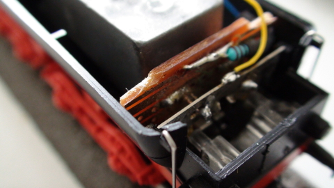

It is equipped with a 6090 decoder with a 701.13 chip. It is equipped with two smoke units. Apart from lights and smoke, there are no other functions available using my MS2. Can anyone suggest a retrofit decoder that would add at least chuff and whistle, and maybe acceleration/deceleration and top speed control.
I have been an analogue guy since 1947 and digital is still somewhat of a mystery to me. I took my first steps into the world of Digital just last November. I am not afraid of working with electronics, I do it often.
I have added a picture of the current decoder. I do not know if it is original or was added by the first owner or the dealer.
Thanks in advance for any suggestions and help. Smile

I have that loco. The existing decoder does have adjustable acceleration and braking delay and maximum speed. That is what the two potentiometers on the decoder are for.
It runs well on digital as it is, but if you really want to upgrade the decoder it should not be too hard. For sound you would have to find space for the speaker, and it might be tricky to get a decoder sound project that matches the chuff rate to the two sets of cylinders.

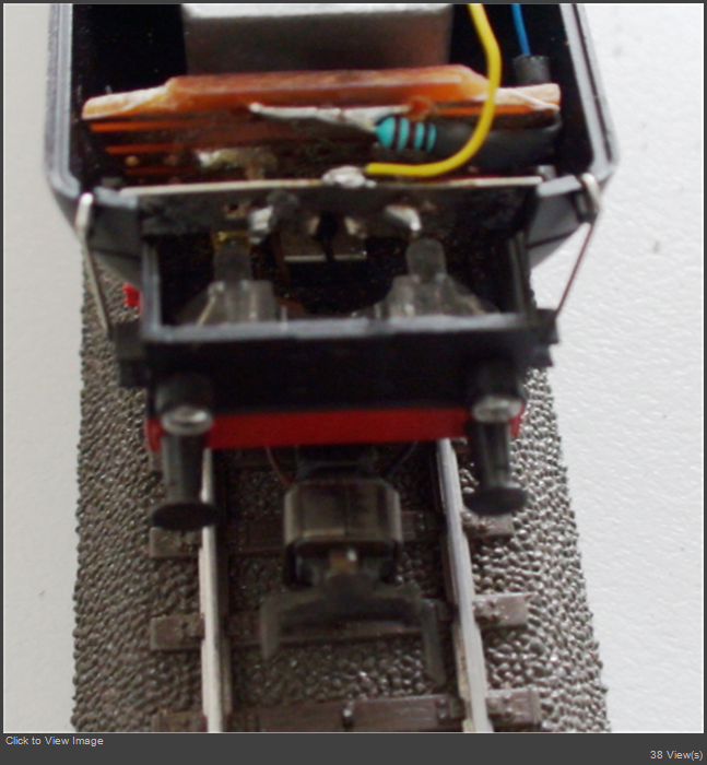

Hi Ray, You are right about the pots on the circuit board, I had forgotten that. I need to take the cover off and adjust them. Acceleration /deceleration are fierce right now. I suspect that they have never been adjusted.
Regarding the space for a speaker, The tub tender is a bit tight on space, I can check under the boiler too.

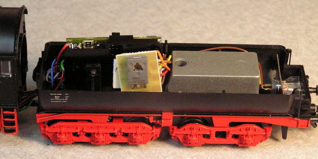

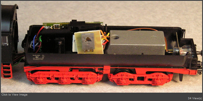

Hi, as you can see, a 21 pin interface + deco + speaker, should fit in the tender with no major modifications.
The speaker dimensions are 33x17x10 mm
As for the sound files, my dealers were also kind enough to upload the project that i have asked for ESU decos, being the nearest one more than 14000 km away...LOL
thanks 3 users liked this useful post by franciscohg

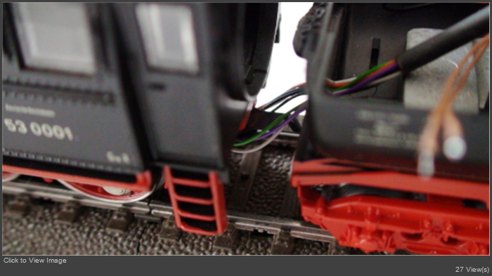

Hello Peter, this is a factory equipped decoder, loco is 37024
Have done any conversion on it. I have installed one in a 3102, but was an old lokpilot, no sound, so the space was not a problem.

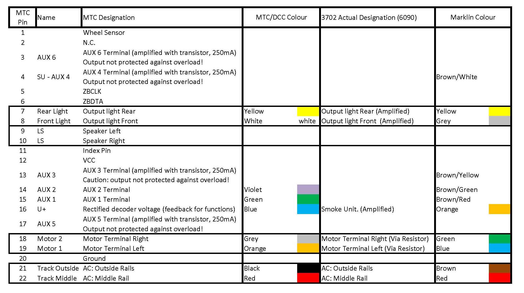

As an exercise in futility and confusion, using Francisco’s 37024 as an example, the exploded view shows a part number 163 746. I searched the Marklin site for said number and it seems all of the Marklin decoders use a 5 digit number. Confused
I browsed through the ESU on-line catalogue too but don't know where to start...too many choices.

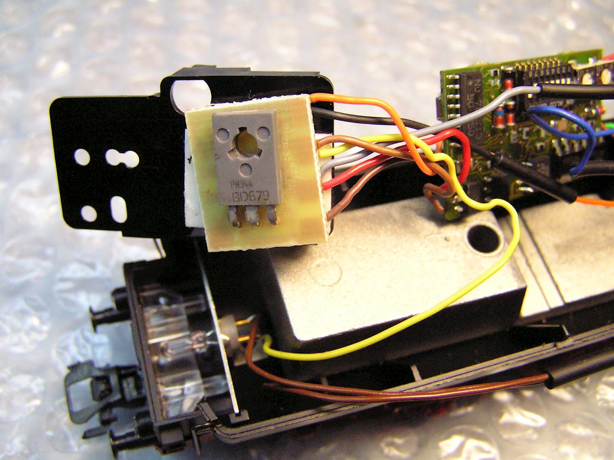

Peter, I have done several BR 53's with sound for clients and one for myself which I've sold later on.
what I've done is changed the decoder to an ESU decoder (21 pin) with an ESU adapter plate (51968), led's front and rear and the speaker if I remember correctly was placed into the tender., I'm going to look for pictures and if I find them will post them here, I've added other gadgets as well, cab light, side rod inspection lights and fire box light.

#37 Posted : 12 April 2017 13:40:44(UTC)
Posts: 14,888
here are some pictures from my conversion back in 2011
Thanks for the pictures John.

ESU list both the DCC colour codes and the Marklin colour codes. See the downloadable manual at http://www.esu.eu/en/downloads/...anuals/digital-decoders/
Thanks Alan, I have downloaded the manual for the V4.0 M4 decoders, but cannot find a copy in English for the 51968 21MTC adapter. I copied the table from the German instructions and set it into an XL spreadsheet and translated it which will make life a lot easier.
Two things I do not understand are the purpose/meaning of "U+" [Rectified decoder voltage (feedback for functions)] and "SU" in SU- AUX 4. I'll see if I can upload a copy of the table.
Peter B.
Here is a better copy of the table in jpg format. Hopefully there are no errors.

#43 Posted : 21 April 2017 19:15:52(UTC)
mb300e4m
Joined: 07/06/2013(UTC)
Posts: 439
Location: Florida
This device is a BD679 "Medium Power NPN Darlington Bipolar Power Transistor for use as output devices in complementary general-purpose amplifier applications."
Four wires are connected to the 6090 Decoder, the remaining three feed the front and rear lights and the two smoke units. It is attached to the plastic 6090 board cover with double sided tape. I assume it is OK to cut it out and put it in the parts box, never to see daylight again.
Question: Next step is to cut all the wires connected to the 6090 decoder board and this device, yes?

#44 Posted : 21 April 2017 21:18:49(UTC)
Posts: 11,165
This is one of the reasons I have not upgraded my 3702, that extra power transistor - will a normal mfx/Esu decoder be able to drive the lok without it or should it still be there?

Oh yes, it is capable. One advice when converting, i find the work neater when you strip down all the cables and replace them completely with the ones provided in the adapter board (Marklin or ESU)
The transistor only powers the lights (two incandescent bulbs) and two smoke units. The new interface board has four amplified connections, I am not sure what power they can supply. Some research is needed I can see.
Anyone know what the current draw is on a smoke unit?

I answered my own question when I posted the chart earlier. The amplified connections will supply 250mA. Now to figure out smoke unit current draw, anyone care to guess?
Francisco, then it is safe to assume you relegated the power Transistor to the scrap.
I agree with you about cutting the wires back, did you cut them all the way back to the devices (motor etc) or did you splice them to the adapter wires at some point. I may cut mine back to just inside where they enter the tender body and splice them there. Otherwise there may not be enough room in the body to stuff all the untrimmed wires in.

Peter, since the suplied wires are very long, i always try to run them to the end device, pickup shoe, motor, smoke unit, etc. Less connections make less failure points.
The other thing i forgot.to tell you is since they are two smokes.units, and to be on the safe side, i wired them trough a mini relay to the decoder.
