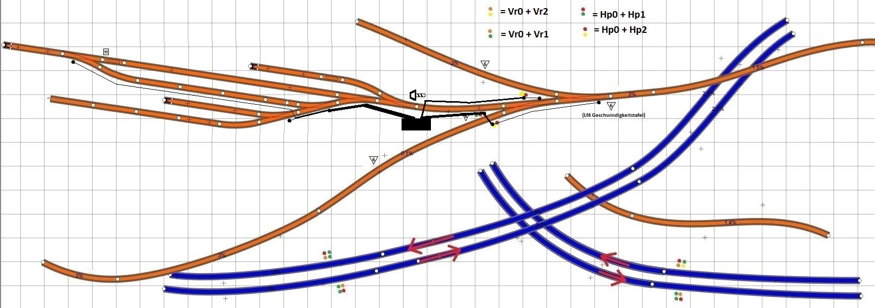

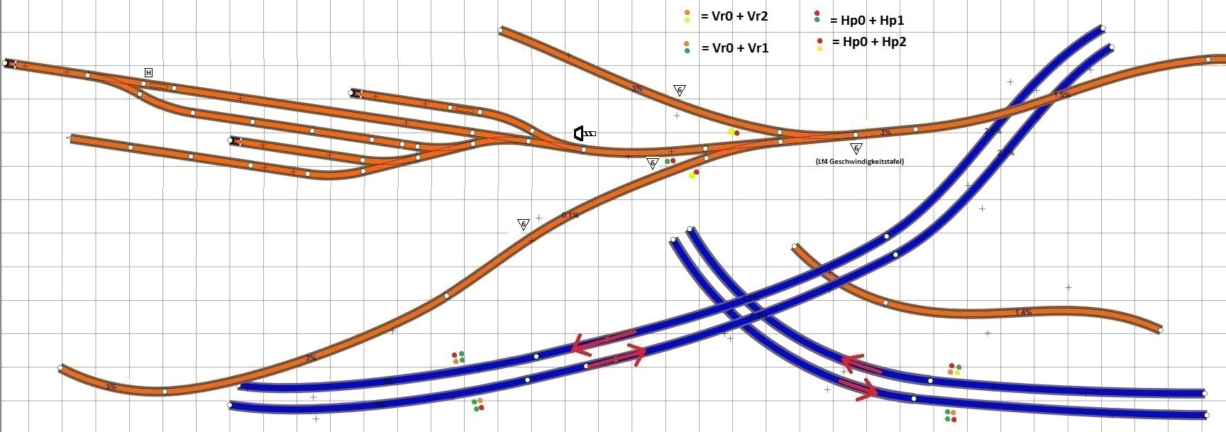

Here you can see my layout plan of my branch line area (shown in orange). The blue is the main line and is at a lower height.
I am looking to have a signal tower probably to the south-east area of the branch station. I need to know if weichenspannwerk would be used for the far west turnout and if weichen and signal spannwerk would be required for the 2 turnouts/3 signals to the east.
I have also wondered whether a signal tower here could conceivably control the 2 sets of signal system on the main line below.
The set of signals to the east lead into the main station though so I would think the main station signal tower would be controlling those through interlocking.
If I am to model spannwerk in any of those situations, how far from the turnout/signal would the spannwerk be located?
Would they have dual cables feeding into one end and back out the other to the signal/turnout?

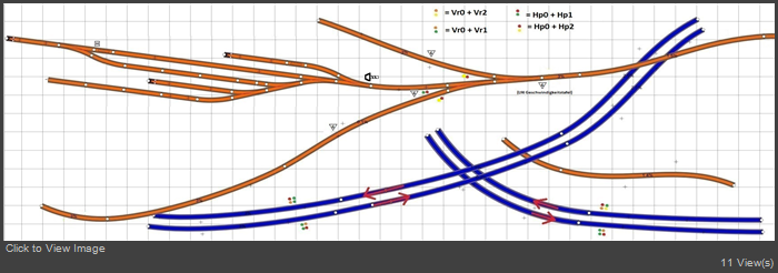

draft plan with no spannwerk:
You need a set of spannwerk for every wire-operated device i.e. every set of points and every signal.
One of the good things about wire-worked points is that they can be operated at much greater distances from the signalbox than rod operation will allow. All the points on your layout would be within range of a single signal tower placed where you have in mind.
If I understand this correctly, this is the drawing showing the wire runs, so should be the draft plan with spannwerk
If I am right, then the layout of the wires looks fine, as does the positioning and type of signals. However, you need an Einfahrsignal (Hp0/Hp1/Hp2) to enter the station with an associated Vorsignal. If the station is a dead-end (i.e. none of the brown tracks continue to the left), then I am not sure if the Vorsignal would be worked or just fixed in the Vr0 position.
Robert

Posts: 1,805
Originally Posted by: Robert Davies Go to Quoted Post
[You need a set of spannwerk for every wire-operated device i.e. every set of points and every signal.
Interesting because I see many examples where no spannwerk is visible which is also shown in the Weinert guide - in these cases though I believe the spannwerk is contained in the lower floor of the stellwerk (signal tower), with the interlocks on the upper floor with the operators. Is that correct?
If so, then it must mean that single story signal towers would typically have external spannwerk for all lines and the larger two story signal towers would typically not have any external spannwerk - unless the signal tower was 'full' with no room for them internally and may then have lineside spannwerk?
I said no spannwerk because I have not indicated any external spannwerk on the plan, only troughing. This relates to my previous post regarding when spannwerk is used and so whether or not I have visible spannwerk will depend on whether I use a single floor signal tower or a two story signal tower with internal spannwerk.
In regards to the entry Einfahrsignal (Hp0/Hp1/Hp2), my branch station has local control with no signals with exit signals only required as it clears entry onto the approach track from one of three directions. I had thought with the plan that since there is only one approach track which the train would already have signal clearance to enter, he would then have a clear route either into the station or off to either branch?
Ok - I understand now about the plan and we have now reached an understanding about where the spannwerke might go.
I don't think that that arrangement is very likely, although you may have a prototypical example in which case I stand corrected. My belief is that if you need signals to exit the station on to the single line, you would have an entry signal leave the single line and enter the station. If when you say "the train would already have signal clearance to enter" you mean that there is a (hidden) entry signal at the station out of sight, then fine but if you mean that the signal is at the other end of the single line controlled from somewhere different then there is nothing to stop an approaching train from entering the station even if the points were not set correctly.
An alternative, if this station is very little used, would be not to have signals at all and just use stop boards and hand points but that rather defeats the objective of wanting to model signalling!!
I have been going back through my planning stages as I did originally have a signal in the position you described, though it was then later removed.
Here is my signal thread which I also ended up posting on Stummis forum:
https://www.marklin-user...al-design-for-new-layout
I didn't receive any further comments on either forum about the final branch station design so considered it be acceptable.
I can see from your logic that you are likely correct. I should have another signal, likely just before the turnouts. This signal would control access to any of the 3 directions.
The annoying part is this means I need to buy another signal and decoder (since I have already used the exact ports available)
