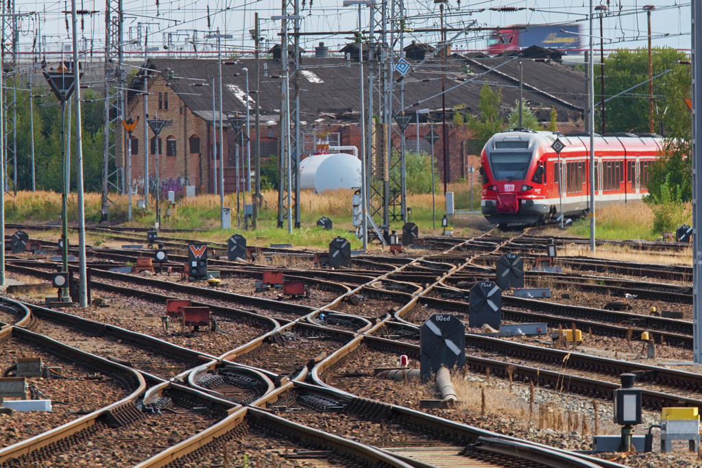

Regarding the branch line signals: This could have been as simple as possible, especially on branch lines with a low traffic volume. E.g., a train dispatcher gave orders and engineers drove at sight, and switches were thrown manually by train crew; warning panels replaced signals. Some signaling diagrams for meeting point (1 example) and terminus (2 examples):
Then there was the institution of a "Gruppenausfahrtsignal", i.e. a single combined exit signal for several station tracks (requiring good communication between dispatcher and engineers). The latter is well illustrated by this 1966 track plan of the station of Pleissenberg (Sulz):
Another oddity: Single-arm Gruppenausfahrtsignal in Emden with 20 km/h speed limit sign on mast.

Speed boards: The "Lf x family" existed already in "your" era in Germany. The indicated number x 10 equals the speed limit expressed in km/h.
Lf 4 speed board on signal mast.
I now need to re-work my signal plan now that my layout design changed a bit and I just realised the significance of this picture.
You have 3 tracks coming into a single track and yet the signal is located at the turnouts; I would expect a separate signal for each track before the turnout and that is all.
I was thinking if I should do this for my branch line area where I have 3 tracks (2 for the loop, 1 for station) coming together, Instead of 3 signals at each approach.
Though then I realise the problem is, if multiple trains are waiting to use the track, which one would go - so I do not think this is suitable for me.
It might be that we just don't see in the picture above that there is actually a separate signal for each of those tracks before the turnouts.
Onto a real question though, I was thinking about the pass through track in a station area - would it even need a signal?
I do not think it would be required if the track is purely for a pass through and no trains would be stopping there.
The entry signal before the station would allow the train through the passing track and continuing on the main line.
If a train is departing from the platform, then the entry signal would be red preventing trains from using the pass through track...
#39 Posted : 21 July 2016 21:53:25(UTC)
The trick with this photo (and any photo) as you noticed, is that we don't see the full 360 view nor know about the location and what the traffic feeding INTO the switch on the 3 lines coming from the camera position is, nor what happens around the bend past the signal.
One reason I can see there being a need for only the one signal: the signal is all about what is around the bend, where this is a branch line joining some other main line.
Imagine that behind the camera person the 3 tracks are in an industrial park coming off of loading docks, and its all clearly visible whats what - a mini switching yard even. Got forward the way the track is heading is the single exit out of this complex on to the more general rail lines - say the DB switching area or onto the main lines in general. This signal just makes sure no one exits the industrial area without it being properly coordinated with the main rail system around the bend. Behind the camera position, it might be all visual operations. The fact that there is an at grade crossing right there (gates up on the left of the photo) indicates this line is indeed a very rarely used line with the grade-crossing traffic also not being very heavy.
Is that enough "360 view" - see video?
:o)
