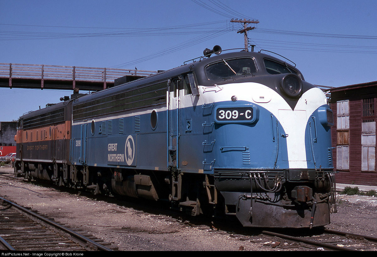

Marklin's model is 309-A and 309-C. These units are listed at 241,000 lbs each, built October, 1950. These units were not by any means photo shy.
309-C in Saint Paul, MN, 7/15/1967:
And in Naperville, Il 4/20/1963:

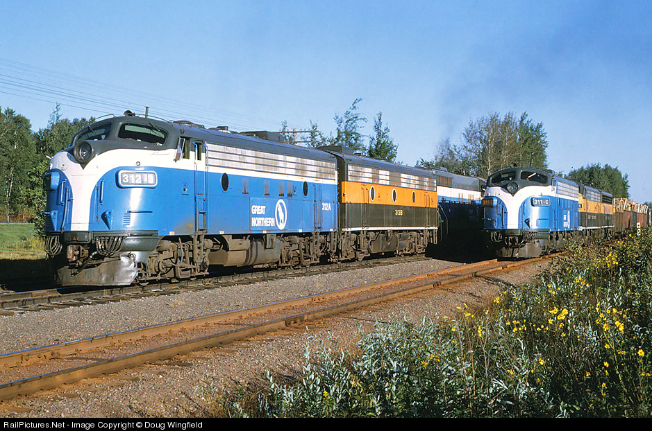

Regarding liveries, from the late 40s through the early 70s (prior to Burlington Northern), GN had at least four distict liveries on cab units. The livery choose by Marklin and represented in the previous photos is the 2nd chronologically (and best looking IMHO), used from the early 50s through the late 60s. Here is 309-C in Minot, North Dakota July 2nd, 1969 with the final GN livery prior to BN.

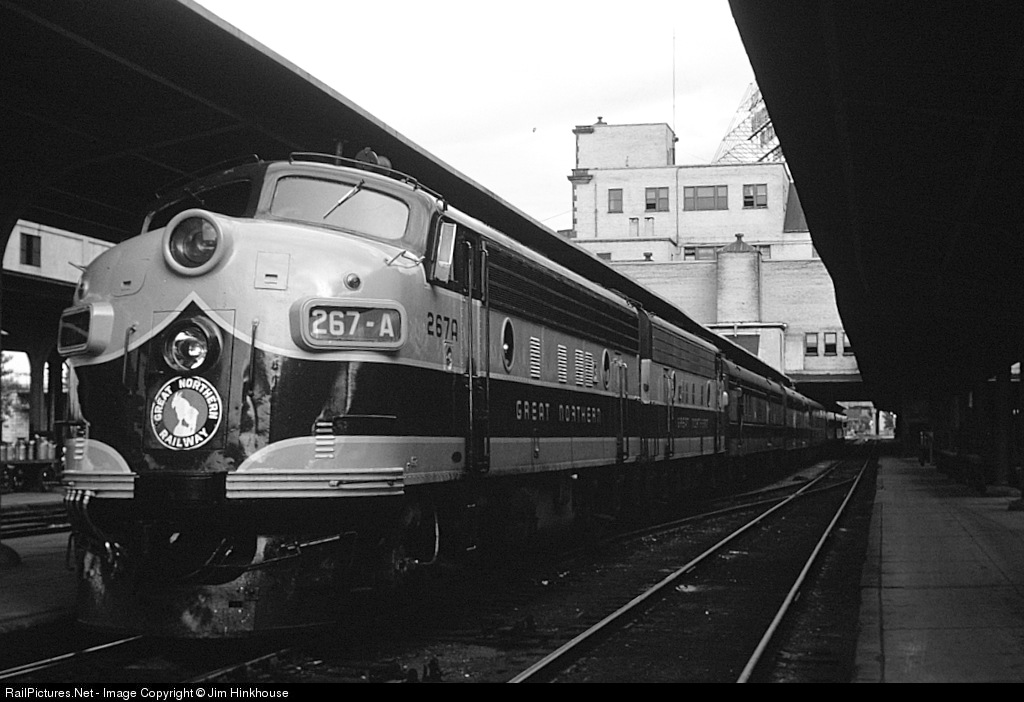

The GN F7 units were freight units had a single headlight as far as I can tell. Some passenger units had the MARs light.

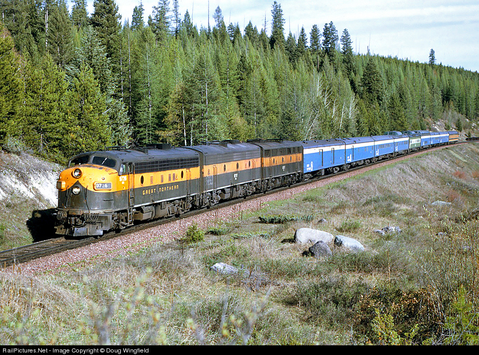

Like most US railroads, GN ran large motive sets. However, it is possible to find some A-A units for inspiration:
Location/date unknown:
Tacoma, WA , July 1957 (note the plow fitted):
Minneapolis, Minnesota, Summer 1956:

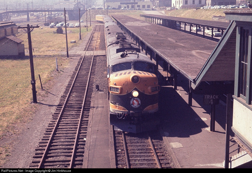

As far as I can tell, in the 300s, units 350-365 were used for passenger service, meaning 309A and 309C were destined to a life of hauling freight. However, it wouldn't be too much a stretch of the imagination...

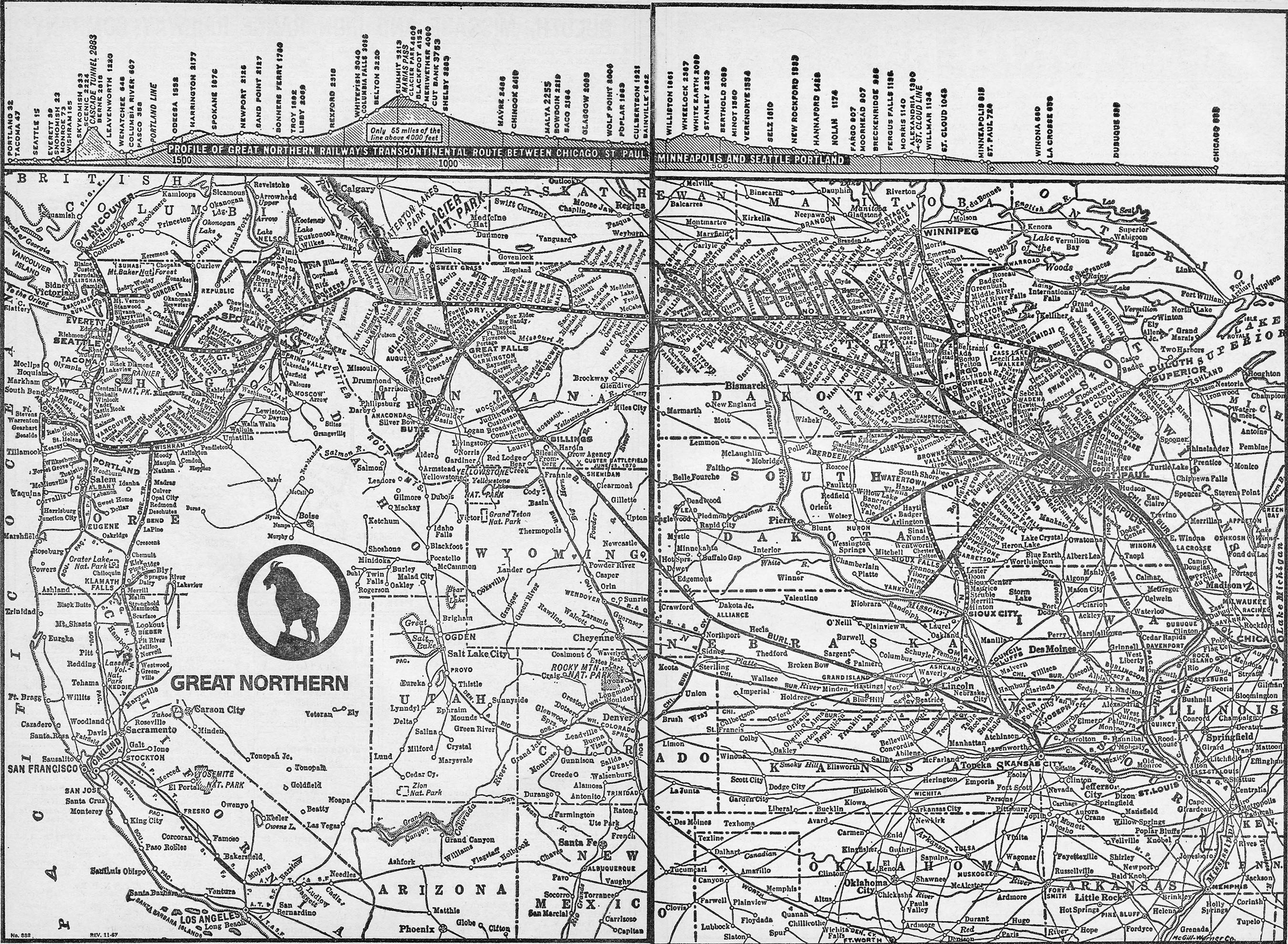

And finally, regarding geography, GN, much like my beloved D&RGW, passed through the rockies in the wild west:

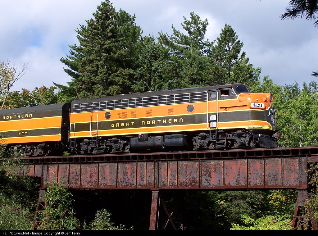

Unit 423, which has been restored sometime within the past 15 years, does sport some silver vents:
