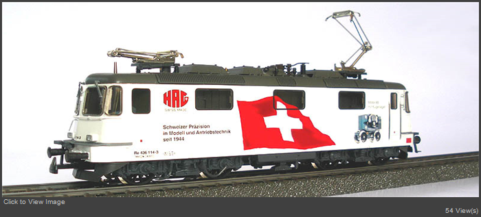

Admittedly, using masking tape to achieve a nice color separation line is not an easy task - but professionals should know how to accomplish this.
Take a look at the area above the front windows:
Re 420 LION
On the positive side, the running characteristics of the model I tested were surprisingly good even in analogue AC operation. Could it be that they are finally beginning to listen to their critics instead of stubbornly ignoring them? Wink
For comparison Marklin's Re 420, cat no 37348
[img=UserPostedImageIMG_0603 by Robert Cant, on Flickr]Marklin Re420[/img]
As you can see from this admittedly poor picture our boys and girls at Goppingen have learnt how to use masking tape.
Metal body? you got it! Metal chassis? you got it!. Digital? yes with Marklin's own MFX, not surprisingly when I put it on to the track it said "yo blood" to the MS2 and they bonded immediately.
New Hag attaches great importance to lights, well this has lights in abundance, different combinations of front, rear and warning lights, not to mention cab lights as well.
Sounds? oh yes, engine, compressor, brakes, whistles (both loco and guards) the list goes on.
It is quiet, smooth and appears to have all the power that I will ever need plus more on top, this appears to be available for around 235 euro's, I think someone needs to raise their game a whole lot more....... regards Rob

A crazy auction result: A unit of the HAG model shown in the picture below was sold for no less than 5,516 Swiss Francs (approx. 5,089 Euros) in a Swiss online auction (www.ricardo.ch) last Saturday! 50 of these had been produced for the last Christmas sale at the factory shop in Mörschwil in December, 2011.
Prices for rare models that were made by the old HAG company generally seem to be rising - probably due to the fact that the traditional quality standards are no longer achieved by the current successors... Crying

#497 Posted : 13 December 2015 17:57:03(UTC)
Mmmh.
There's one just like that in the display behind me.
Time to put it in a safe???😊
