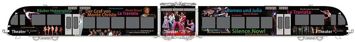

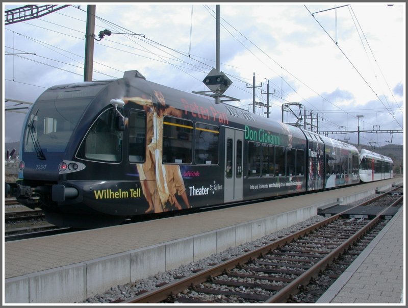

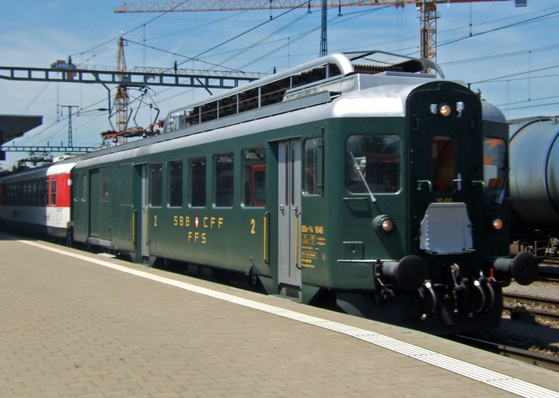

And do Hag make modern railcars ?
Sorry, no modern railcars from HAG. Their last railcar was the BDe 4/4, a prototype from the 1950's. http://www.bahnbilder.de...r-bde-44-1646-295191.jpg
Or the series of GTW railcar sets, but these are a bit hard to find and expensive: https://upload.wikimedia...ons/e/e3/Stadler_Gtw.jpg

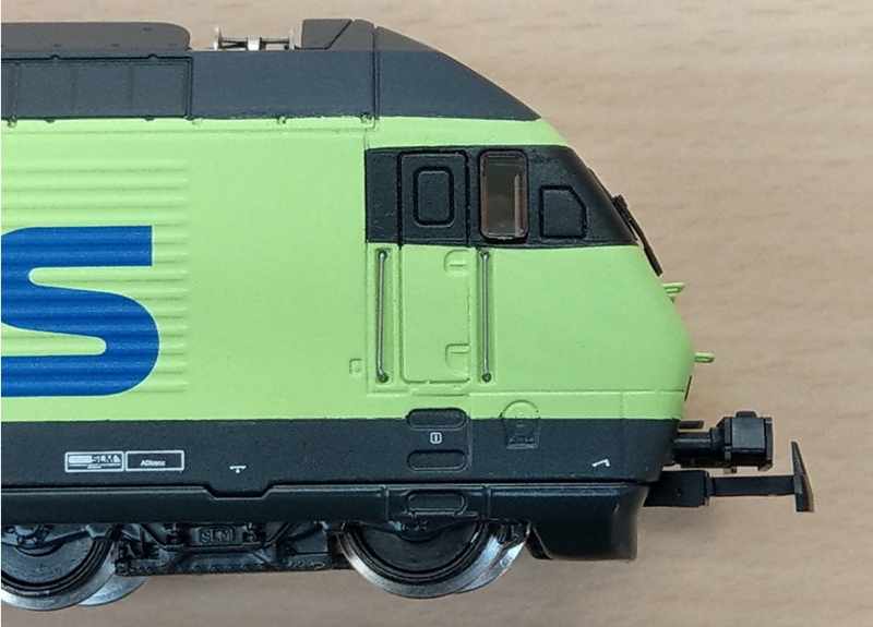

A quick one for those in the know, are Hag fitting Faiveley pantographs onto the latest 460's? cheers Rob
So far no, but they have spread a rumor that they are developing their own Faiveley ("better than the one available from Roco"). However, if this is just one of their usual ritualistic announcements and promises, it is likely that only the very young among our esteemed forum members will be able to view first samples of this product... Bored ThumbDown
It's definitely not "usual ritualistic announcements and promises", here is the (translated) official announcement from this morning:
Re 460_Faiveley_Panto_en.pdf (201kb) downloaded 102 time(s).
The HAG Faiveleys are even capable (and tested) to be used in catenary operation.

I wish other manufacturers would follow HAG and produce pantographs one can use for catenary operation but I think Märklin is very close providing sturdy pantographs
#626 Posted : 06 January 2018 03:17:24(UTC)
Posts: 8,342
The Hag brochure (flyer) shows what appears to be the Maerklin pantograph. It is accompanied by a disclaimer that "slight deviations may occur to the final model".
I wonder if Hag will succeed with a more prototypical but still useable pantograph blade.

I assume that HAG buyers have become an extinct species by now, but just in case you are thinking of buying one of their models, please take a look at the current precision of their "handcrafted" colour separation: Crying OhMyGod
#640 Posted : 27 March 2021 13:18:59(UTC)
Posts: 8,623
I'm not impressed with the fitting of the left hand hand rail either ... Blink
#641 Posted : 27 March 2021 15:12:31(UTC)
Posts: 7,577
What a shame. I do really suppose it will improve but it would be nice if somebody with cash could start again even if with just a few models. I have since sold the few locos I had (one went to Nev in Oz). Now I wish I still had them as in the old days they were well made and ran well.
#642 Posted : 28 March 2021 01:55:23(UTC)
Posts: 8,342
Maybe after Hugo and Alwin Gahler passed the torch on to Herr Schoch and finally Herr Urech, the name changed from H(ugo) and A(lwin) G(ahler) to
H(ad) A(nother) G(affe)?
Paintwork these days should either be done by stamp printing or by spray paint with special tape applied to the model so that it does not overflow the area to be painted. I am pretty sure that Hag Morschwil used to do this by machine, but this looks like it was done by hand, probably by a nine year old. I remember when I was around that age and decided that painting models was not for me.
or maybe they thought that the FFS in SBB CFF FFS meant "for f***'s sake", but then again it's a BLS loco ("Bit Less than Straight"?)
