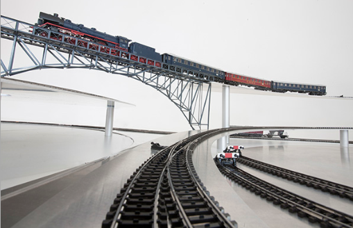

#16 Posted : 15 January 2015 15:06:56(UTC)
Posts: 6,072
Ambitious approach. I could imagine a flyover bridging a yard or a station with areas on two separate levels, but a prototypical excuse for a multi-level layout themed in the low lands is a challenge.
Maybe the scenic ideas of this Dutch compact HO scale layout set in the port of Rotterdam might serve as an inspiration: http://www.scholtze.demon.nl/handzaamh_frame.html
The construction of the latter was documented in "Rail Magazine" Nr. 164 to 173: http://www.railmagazine.nl/default.aspx

Posts: 1,412
Location: Home
Something like this from forum member Thomas Huttel, Huttel topic.
Open Table
(the image is used with permission)
Timaximus
Edited by user 18 January 2015 19:13:46(UTC)  | Reason: Not specified
thanks 5 users liked this useful post by Timaximus
