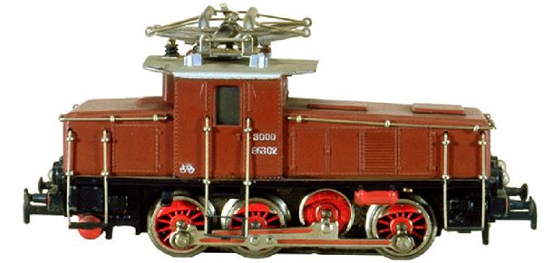

I purchased a Marklin 60943 to convert the motor in my electric Marklin #3000 (E6302)
The direction enclosed shows the mechanical replacement, but does not show the rewiring.
Can anyone help?
#2 Posted : 08 January 2014 00:15:57(UTC)
Posts: 15,542
Which decoder will you use? Wiring instructions come with the decoder. The 60943 motor is not for use with a mechanical reverse unit.
The E 63 02 is not #3000, there must be some error.

I have five electric engines: 1) CE800, E6302 on body (Marklin #3002.1); 2) E6302 on body (Marklin #3001.6); 3,4,5) CE800, E6302 on body (Marklin #3001.1).
I will put 60943 in each. What decoder do you suggest for this set? Is there a set that combines the decoder and the 60943?

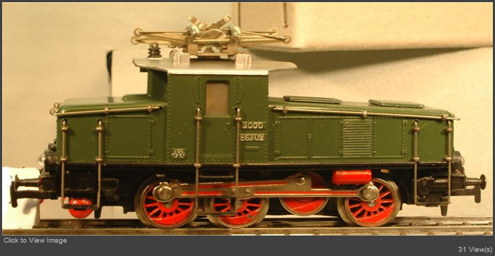

Actually, some of the early 3001/3002 were actually numbered with "3000" on the cab, he may have one of them....
The first version was CE800 (1953-1957), then the numbering changed to 3001(Green)/3002(Brown) but the body was numbered "3000" in 1958 & 1959 production and then corrected from then on with only the Road number, but no Marklin code.
