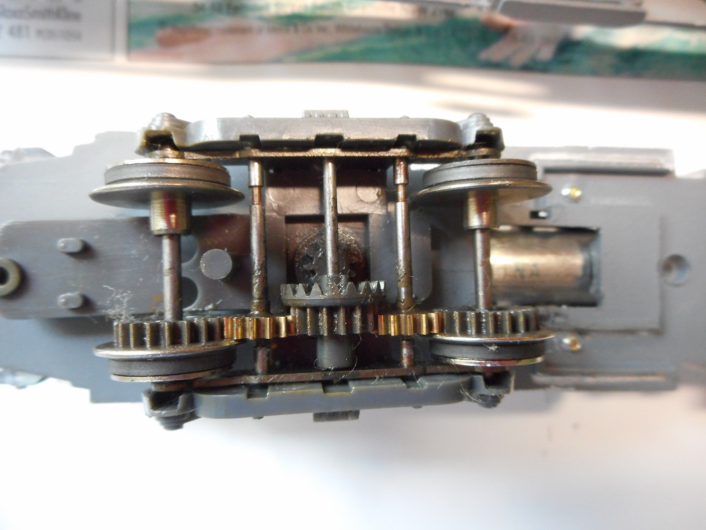

The original open frame motor was clunky when turning but the gear transfer to the wheels was quite well done with a small straight toothed gear on the motor shaft driving a crown bevel gear (from it's underside) to transfer the drive vertically down to the bogie. The bogie used a similar gear/crown gear arrangement to drive both bogie axles. I think a standard Jouef setup. Cop the hair !!

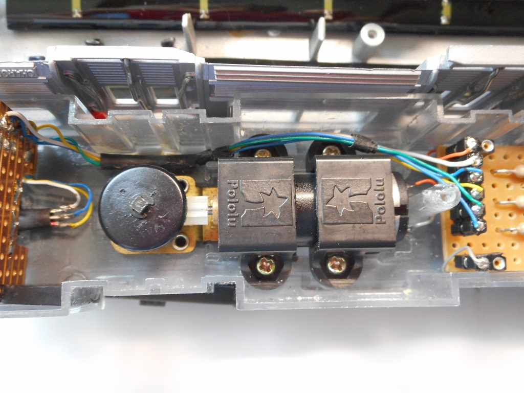

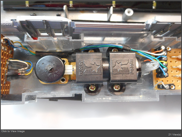

I made the decision then to re- motor it with a Maxon motor and as luck would have it I had a small gear which had the same modulus but one less tooth. This helped to make a slower smoother low speed.

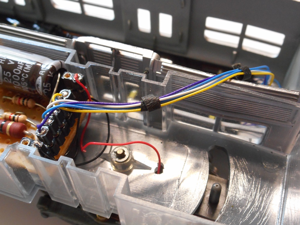

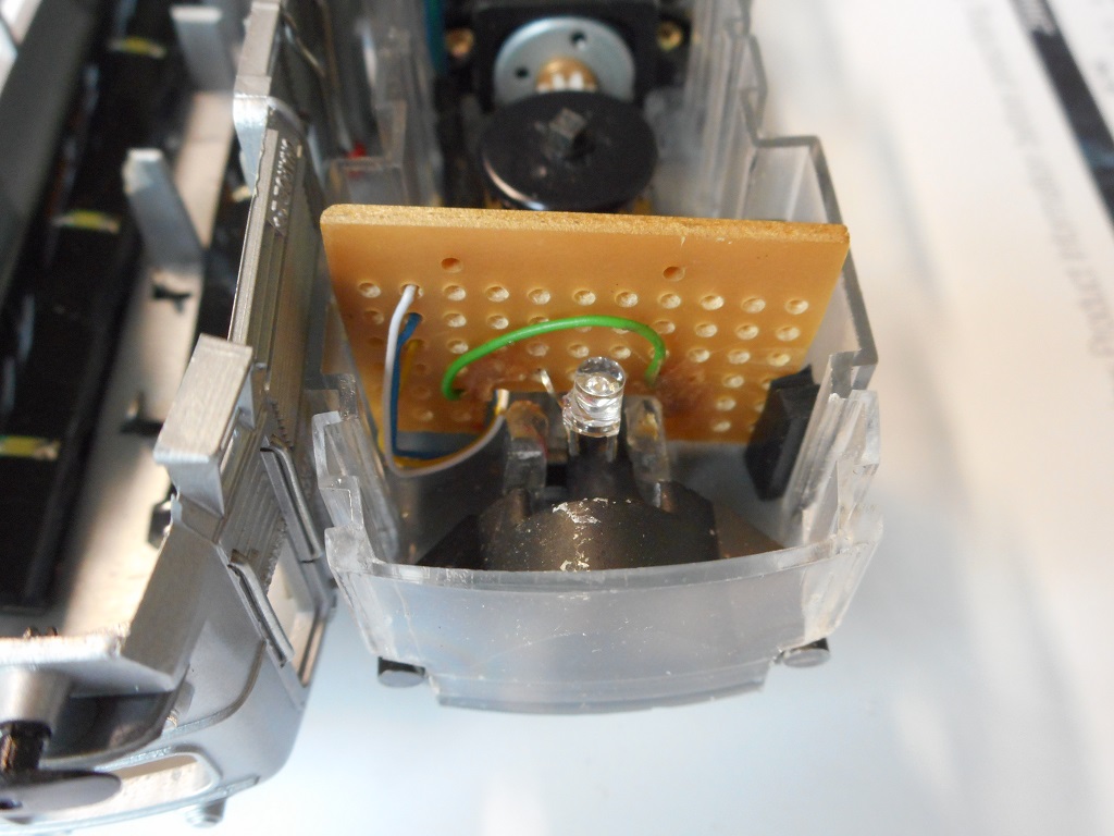

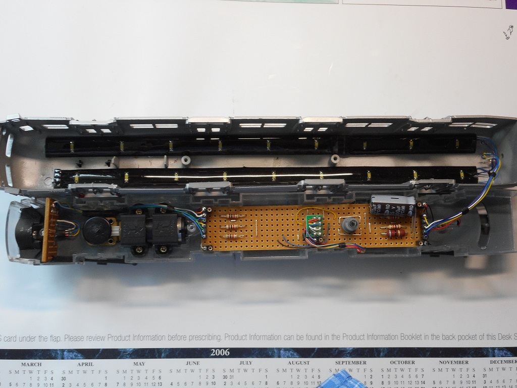

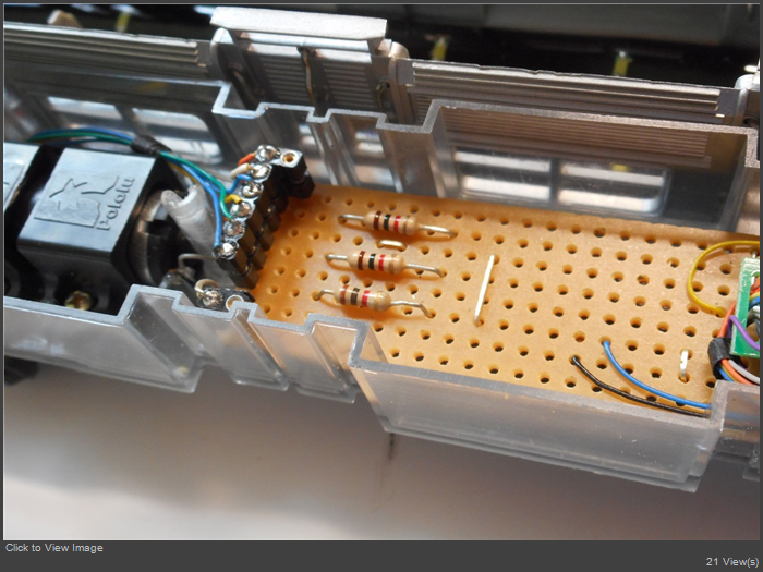

Next came Vero board, decoder ( sits under the board), front and rear red/white change over LEDs ( common anode type), front cabin light and interior roof lighting.

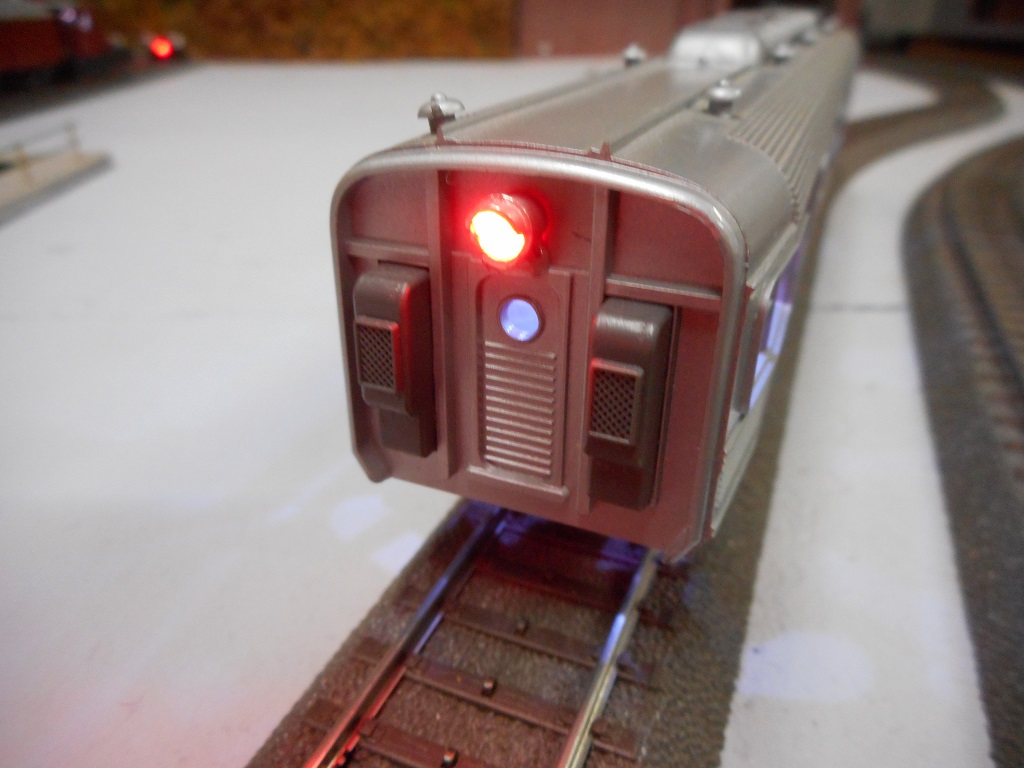

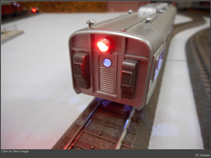

I believe the railmotor has a trailer which I don't have so I mounted a small external light on the tail end for red/white changeover.

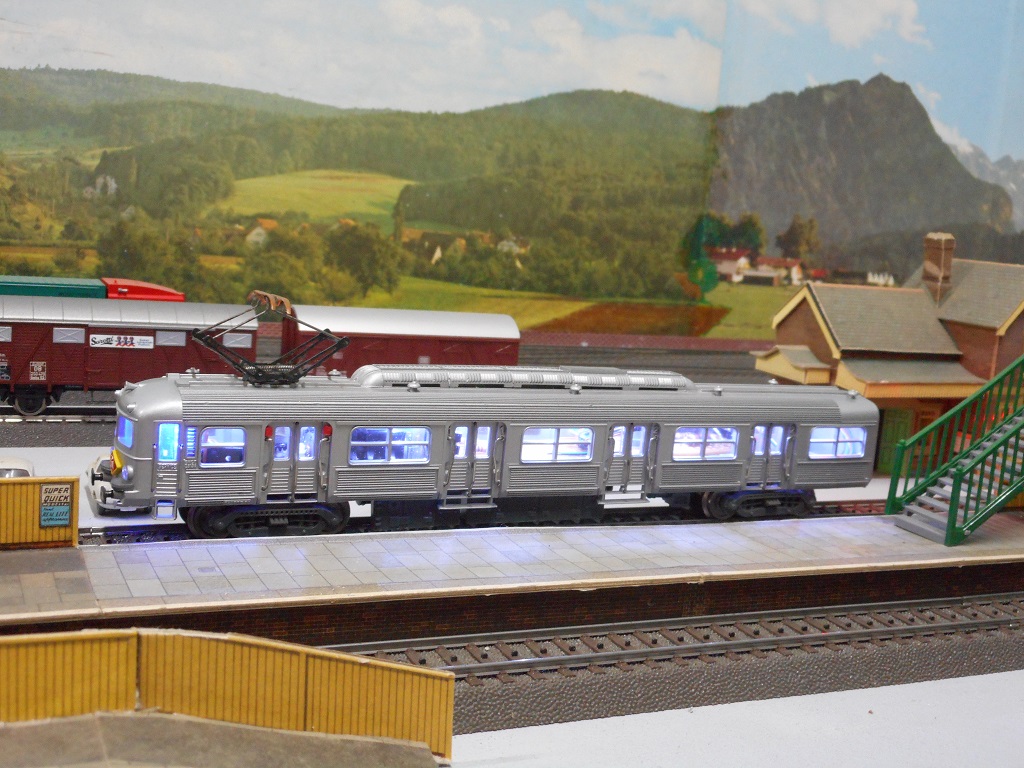

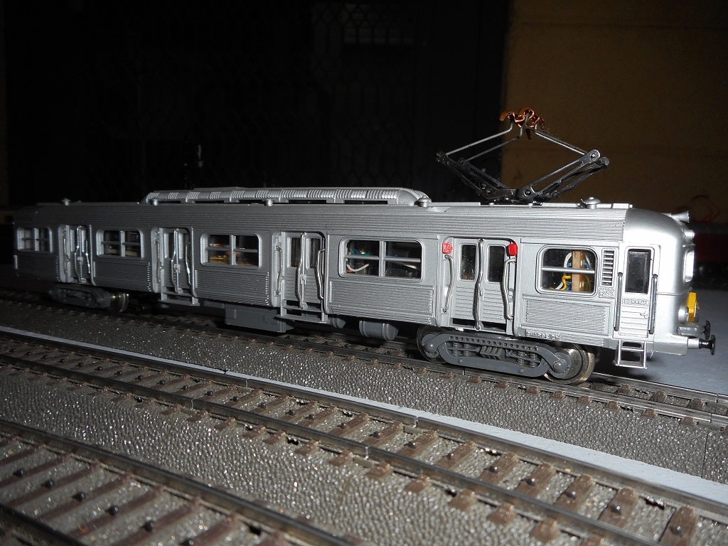

This is how it ended up. I love the model, now it runs smoothly and quietly on digital (thank God). A bit too much guts showing through the windows though.
