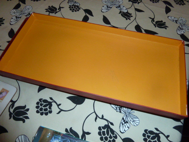

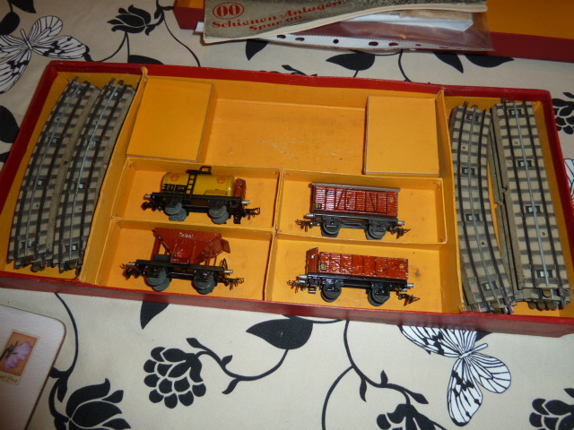

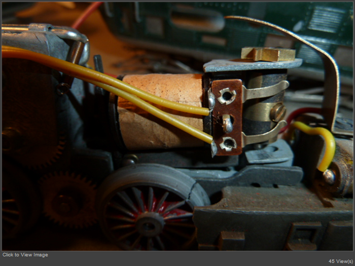

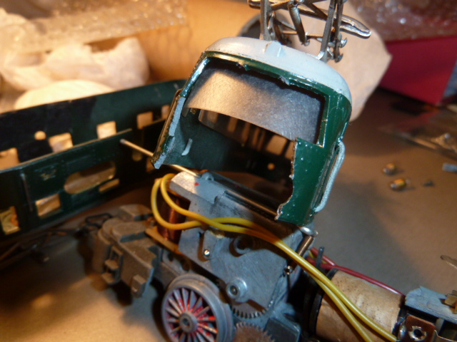

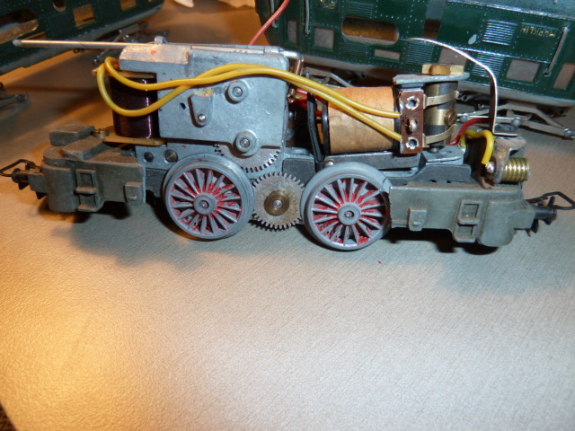

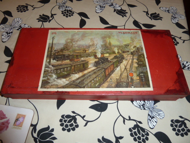

I have had the box lid restored by a local book restorer. It was expensive but my theory is that if I don't do it nobody will. I think he did a fantastic job. I am now looking at the RS 800's that I have and questioning if its worth spending any more money on them. I have attached a few photos of the project so far. I am reluctant to replace any of the fatigued parts with original as they will go the same wayor more than likely break while replacing them. Ritter sells most of the parts but it will cost 100's Euros. What does everyone think. I forgot to mention that there are 2 RS 800's in the photos. One of the bodies has shrunk by about 4mm which makes it impossible to fit onto a frame. the other obviously has suffered the same fate and destroyed the front. I have also been able to decifer the label and confirm that it is a RS 865/4. It may have been a so called PX set as the label reads 1/RS 865/4. I have never seen another starter set with a 1 in front of the number.
Roger

I think all restorations are worthwhile if they enhance the value of the piece and/or add to your enjoyment of it. The box restoration looks like it went really well. For the loco, I would only send it to RITTER if you find all the original parts yourself and simply have them put it together. Otherwise they are going to use their flimsy parts and chances are they won't put the right version parts together (from what I've seen they aren't very careful with that). I have all the parts needed to build a 1947 RS 800 except the shell I have isn't the right version. Let me know if you need anything or additional info.,
Paul

Thanks for the advice. My experience with buying original parts is that if they are cast then the chances are that they may have not shown any apparent detioriation but its there and it does not take much force to break bits off. For instance the casting for the reversing units are nearly always broken. There was 2 reversing units sild on German Ebay this week for about 60Euros. The only thing that could be a problem is the frame cast. Ritter sells a new one for 17Euros. Why would you potentially waste the money buying a pretty certain dud. Same with the wheels. You might get them off the axel may be successful but getting them back on may cause problems. With your spares what are you looking for. I would say I need a frame, centre wheel support and reversing cast. That would give me a good start then try and pick up a reasonable body.
Roger

I certainly agree with you about the reversing unit frame...they're almost always broken and the part isn't that significant so replacing it with a replica is not a big issue. However, if you'd like some original wheels I pulled some off of an RS 800 frame and they're good ones....red color paint strong, wheel holes still tight around axle, and almost no signs of warping or zincpest.

PS. If your RS 800 shell isn't too warped and just has the missing end section, it'd be fun to try and reconstruct it....I've got another shell that is badly damaged but has this section present....a careful transplant could be possible!

Can you send me a PM on the wheels and what you would like for them. I have got another shell which has shrunk and did think that I could make one good one. The problem with the one I want to fix up is that is it has broken on the window uprights and there is no way that you could get this off the bad one in one piece. I'm not sure how you could actually remove the section. I could only imagine using a mini hacksaw. A small grinding tool would be better. I have to do an exercise to see if it is worth restoring or selling the two as spare parts and pick up one good one.
Roger
