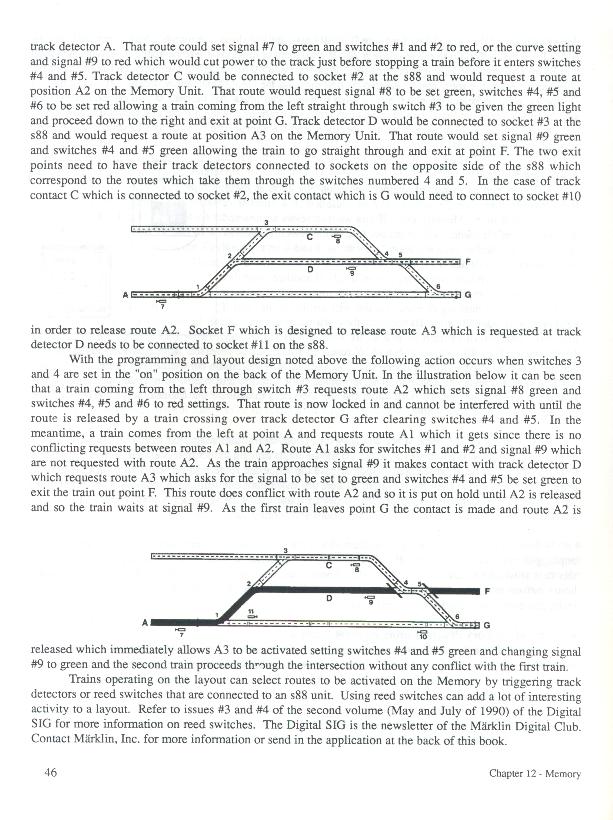

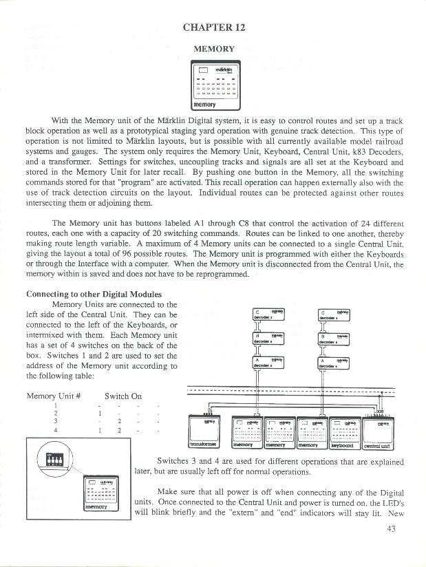

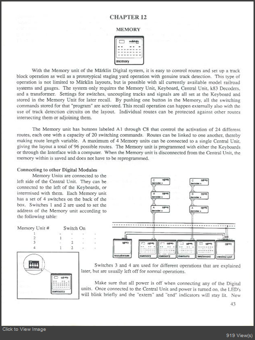

Hi Peter,
While you are waiting for a full manual, the following four pages from Tom Catherall's 1991 book may be of some use....
If you can't read them clearly (make sure you click on them) let me know and I can email direct.
HTH
Steve
