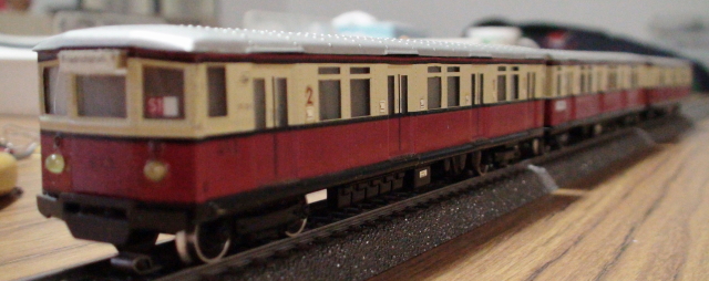

Here is a photo of the 3017 + an extra carriage

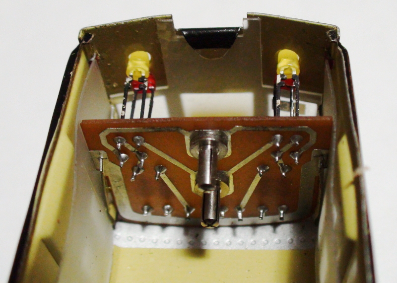

The conversion to digital is a liitle bit tricky because of the LEDs used. I would suggest you to bus a second middle-car, then you have what is called a "half-train". Two of these units together made a 8-car "full-train".
You should also think about a second slider on the non-motorized-end and a decoder which can switch the slider.

The five or six LEDs on every side are mounted together with some diodes and resistors on a single circuit-board. With traditional AC-supply they are switched by the diodes depending on the direction of the current. This won't work after converting to digital without modifing the circuit-boards.
That LED-problem is not insolvable but not usual at all for Marklin-models from the 1980s.

I have to have another look because I had a 6080- digital decoder in it and I can't remember having any problems with it unless I've changed the circuit-board 3 or 4 years ago,
I just looked at the circuit-board and can only see 4 resistors and 2 connection for ordinary plugs.
I agree with you regarding having Led's in locos especially Primex around this era.

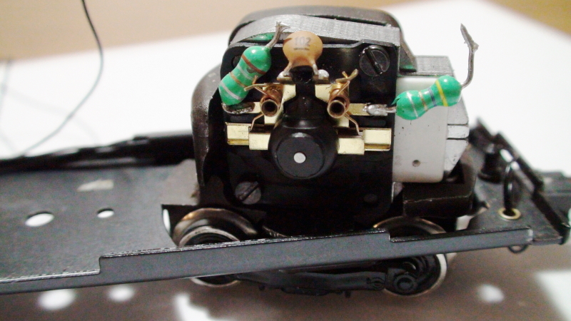

1.)
Digital conversion
The digital conversion consists of a 60903 conversion set.
A ball bearing will be fitted into the brush plate

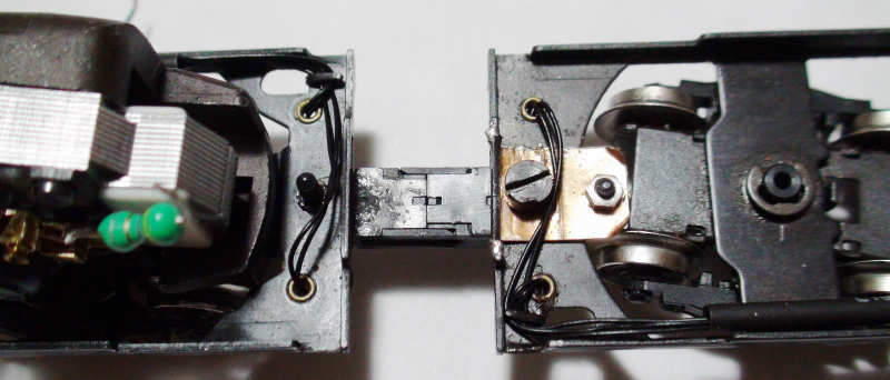

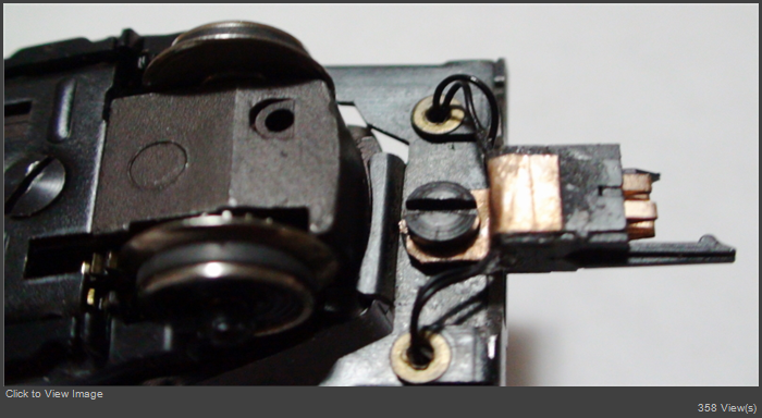

3.) Roco 4 pin electrical coupling
I was slightly annoyed not being able to separate the carriages from each other (permanent coupling, so this gave me an opportunity to install Roco 4 pi9n electrical couplings,
The 4 pins are ideal for the purpose
1.) blue wire: neutral
2.) white wire: front or rear lights
3.) yellow wire: front or rear lights
4.) Aux 1: green wire: interior lights
the fixed coupling was removed and than I had to come up with an idea how to fix the Roco coupling.
My first attempt was by adding a small double brass plate and fixed it to the current screw hole.
The motorcar, this was a different story as there is no room to extend the coupling.
I had to cut off the clip from the Roco coupling, cut off the loophole of the shaft coupling.
To make sure the loophole from shaft is firmly fixed to the Roco coupling I added again a brass plate, drilled a hole the size of the loophole and than super glued the brass plate onto the loop hole and the Roco coupling.
I was pleased with the end result, looks like it is permanently glued on.
I've retained roughly the same distance between the carriages.
The only thing I've altered on the carriage is the bottom cross bar holding the original coupling bar.
the coupling moves freely from side to side so sharp curves should not be a problem.
