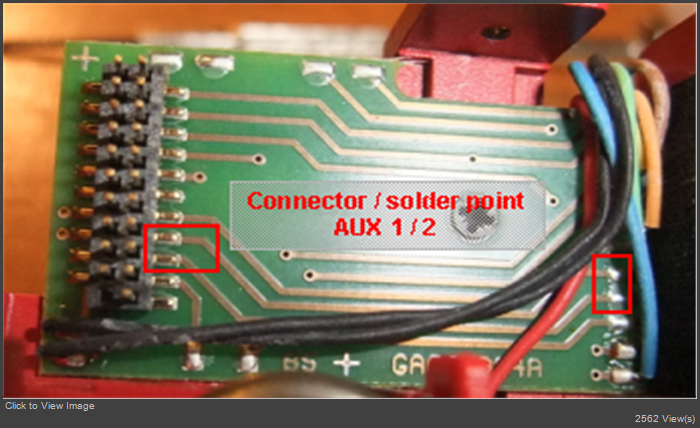

3rd Step: Activate AUX1/2 for rear light
I hope (and it lokks like) that I can solder additional cables to use AUX1/2 of the Esu LokSound decoder to switch the red rear lights separately.
Here, I marked out the connector pins for AUX 1/2, ready connected on the interface circuit board:

Added picture with marked solder points for AUX 1/2:

I soldered two cables to the mtc21-adapter board (brown-green and brown-white) and removed the optical fiber in the motor V36. Then, I placed the LED circuit board. It is 0,3mm to wide, but I was able to adjust it. Now it sits perfect:

I got a CS2 lend by a friend. So finally I was able to activate AUX1 and AUX2 and at leasr I found a bell sound and mapped it to F7:
