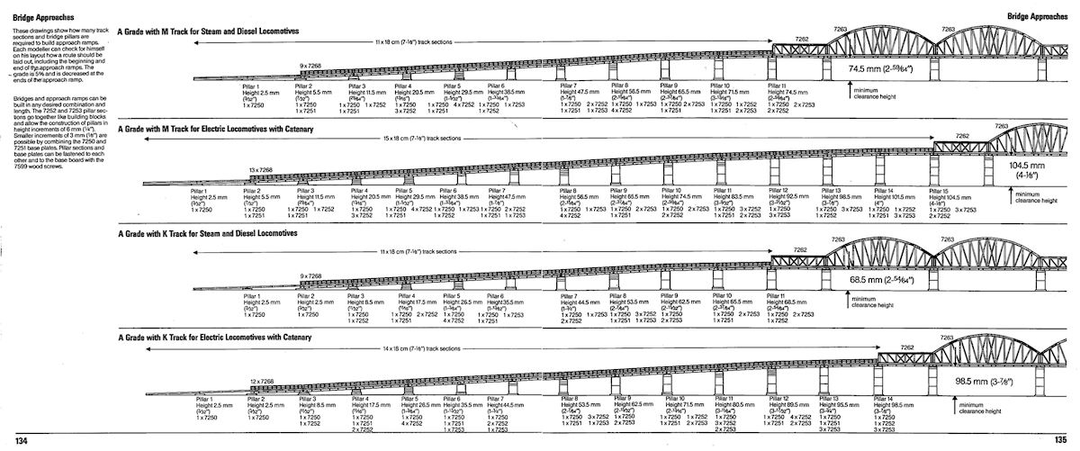

Offline Yumgui
#7 Posted : 13 December 2012 20:13:14(UTC)
Yumgui
Joined: 20/03/2011(UTC)
Posts: 1,660
Brandon, AK,
... I recall that in one of the Maerklin catalogues the minimum clearance was defined in the bridge and ramp section ...
Clear heights for M and K track have appeared in others too, but see here from the 1988-89 ENG catalog ... (see uploaded high rez scan too, for printing on A3 [or 11"x17"] format ^^) :
Yum Tongue
