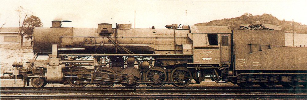

This is a picture I took from the 52 at Neuenmarkt-Wirsberg museum:
Mosty era III DB.

For those who are interested: few months ago a TCDD Br52 is fixed and run after 20 or so years. What an excitement! And yesterday it was here in Istanbul. Here's the link to the photos:
http://marklinciyiz.biz/forum/index.php?topic=1333.0

Thanks for posting the nice photo of 52 5804 and the link to the photos from Haydarpasha Station - lovely!

[size=1" face="Verdana" id="quote]quote:Originally posted by DasBert33
<br />Now that we are back on the topic of 'soviet' BR52s. Here is the one on display at the technik museum of Speyer:
I took the picture myself last fall. Lot's to see there (not only railroad related)
Bert
This must have been the prototype for M* 'T3-5293' SZD models
34159 / 37159 from the year 1997
