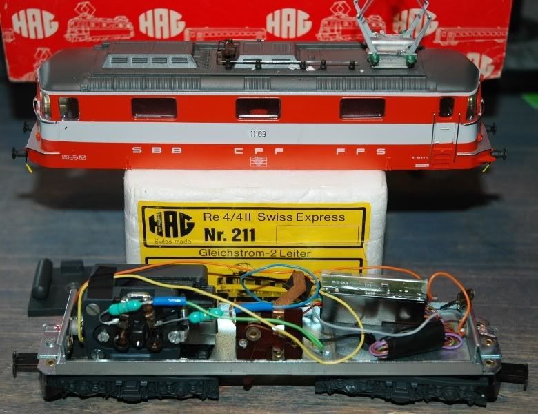

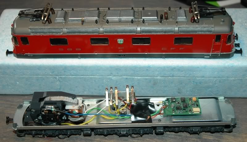

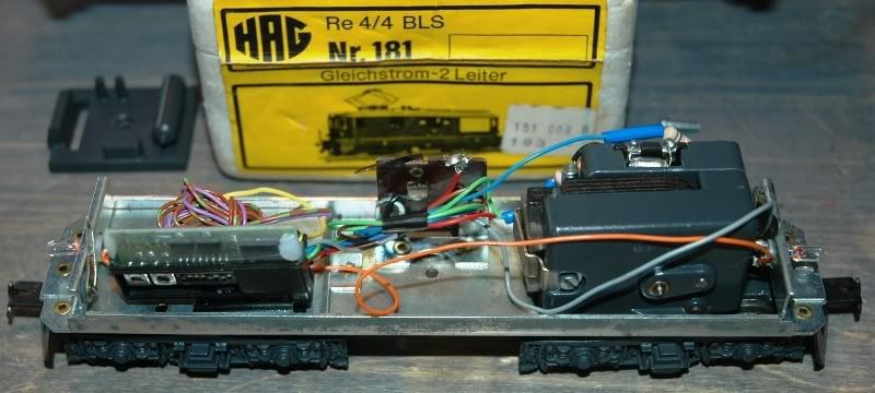

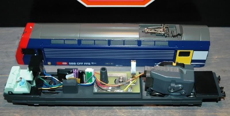

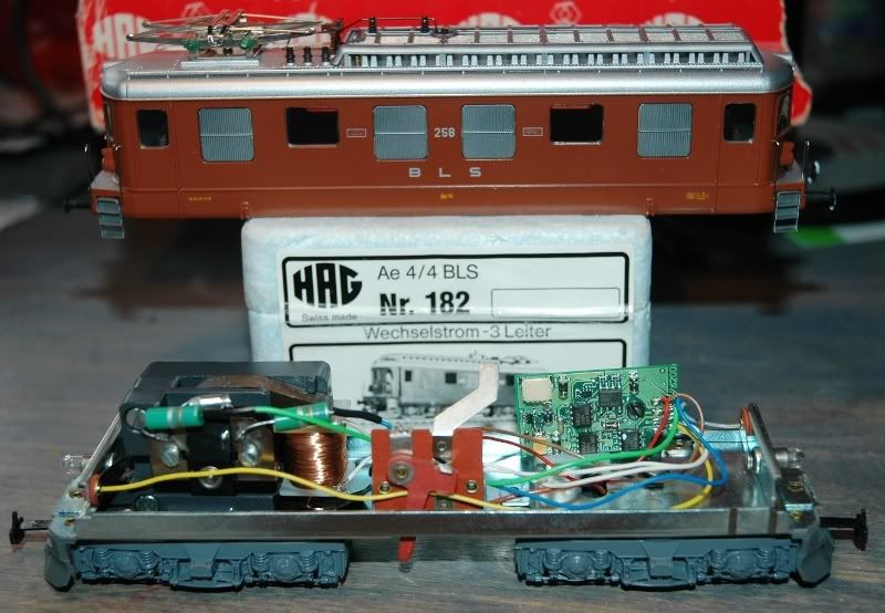

With reference to my old topic on requesting info on HAG conversions (https://www.marklin-users.net/forum/default.aspx?g=posts&t=3882), I have performed some conversions myself and have been asked about results. It was suggested to post some images and comments on this forum so.. here we go. I listed my HAG locomotives by number and not necessarily by the order I aquired them (almost all from e-bay) or upgraded them to digital.

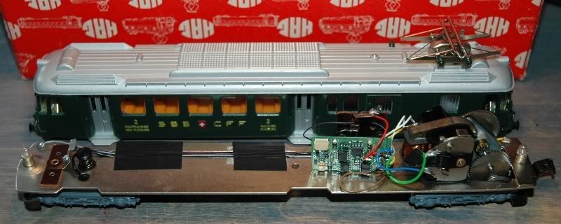

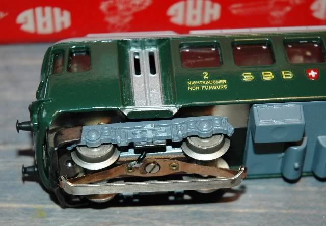

HAG 150: BDe4/4. Originally AC Analogue, upgraded with Uhlenbrock 76200.
It works but the model is pretty old and the motor is very noisy (3 pole). I left all original components only substituted reverse mechanism with decoder. Another couple of pictures
In this third picture you can see one problem of this model. The pick-up shoe (original or changged by previous owner) is very long and it touches on one end with the locomotive plow, which is in metal and connected to the body and thus to the ground. Result, shorting at every switch. Short term solution: isolating tape at contact point. Long term solution, shorter pick-up shoe.

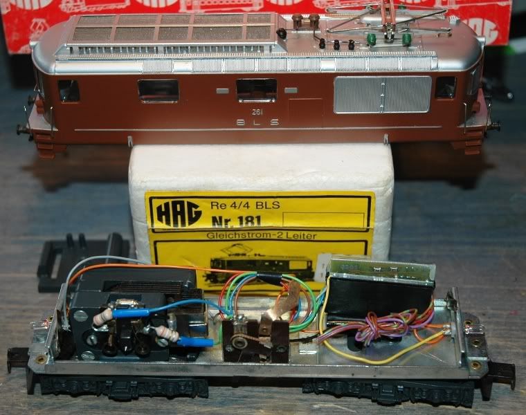

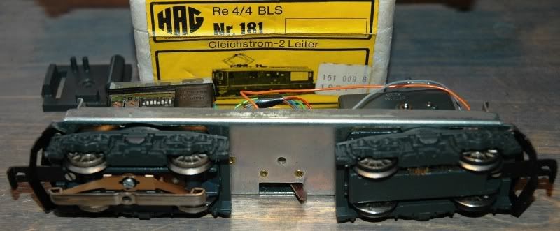

HAG 181: Ae 4/4. Originally DC, upgraded with Marklin 6090.
This was the first conversion. Very straight forward. Substitute the little connection plate, situated underneath the idle carriage and that connects the pick-up point with the wheels on one side, with a pick-up shoe. All other connections are ok. Then you can add the decoder (in this case a 6090). Motor is 5 pole with permanent magnet. In addition, I added the newer lightbulbls and sockets on the two ends. Here are other pictures.

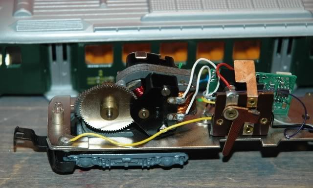

HAG 182: Ae 4/4. Originally AC analogue, upgraded with Uhlenbrock 76200.
This was the first conversion of an AC Hag. Here I had to change the reversing system with the Uhlenbrock decoder. All very easy and straight forward. Motor is 5 pole. I did keep the original lights here since the decoder has not the return function for the lights (I may have to look if I can do it).

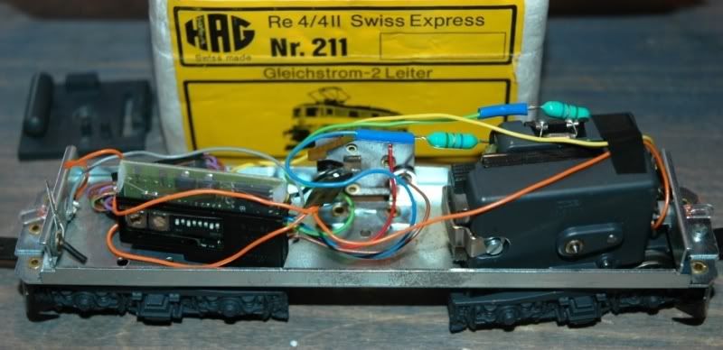

HAG 211: Re 4/4 Swiss Express. Originally DC, upgraded with Marklin 6090.
Same procedure as described for the HAG 181 above. Here is another picture.

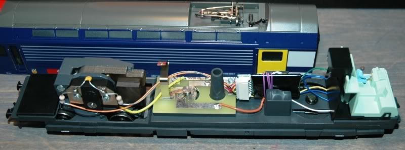

HAG 284: Re 465 SBB Zurich Nahverkher. Original digital AC, no upgrades necessary.
Finally a couple of shots of a modern HAG. I found that on the Eisenbahn-Treffpunkt SCHWEICKHARDT website (http://www.modelleisenbahn.com/) and he should still have a few. I have the Marklin cars and Fleishmann end-car for this train so I was happy to get my hands on this. No modifications required and runs flawlessly. Here is another pic.

Re465 #284: this obviously comes factory equipped with decoder and all. Runs flawlessly over switches and all. Motor is vry quiet. Runs very well at low to high speed.
Ae 4/4 #182: with the Uhlenbrock decoder, this loco runs very well at all speeds. Motor noise is very low.
Ae 4/4 #181 and Re 4/4 #211: with 6090 decoder. I don't like their running characteristichs at low speeds (they seem to be running on and off). High speed is OK. Motor is more noisy than above. They also seem to have random problems on switches (sometime they stop, but rarely.) I need to do more tweaking
