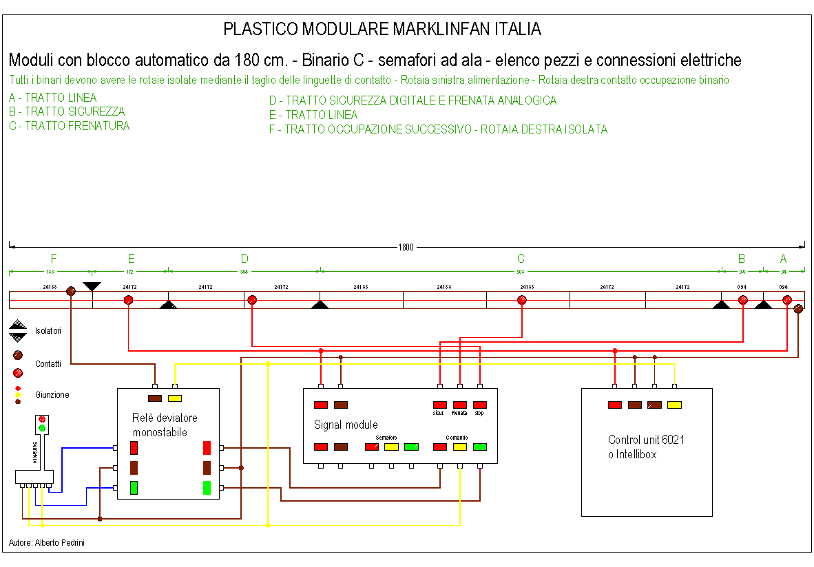

Anybody knows of a relay reference (I'm talking Conrad, RS, Maplin or whatever) with the following spec:
Monostable, changeover contact, coil operated by 16V AC or 24 V AC.
Luis
Good idea Luis,
I had the same last year, nothing found and then asked to a electronic lab to build it for me.
I use it on the block sections of the marklinfan modular layout to control the signal modules and arm signals.
The green led that you see is now changed in a more big diode because frequently it burnt.
Alberto

hmsfix, what Al is saying is that it won't work. You cannot return rectified ground to the Märklin rails. Strange things would happen.
The most benign thing I can imagine happening (mixing DC signal with digital power) would be triggering Märklin's brake mode. The worst would be burning the decoders.
To use this method, you have to use AC controlled relays. I ordered 10 from RS, should be here tomorrow. I will definitely be using these to protect a few blocks in my layout, such as the turntable bloc, station blocks, etc.

Luis
Hi Luis,
It depends on your circuit: put the capacitor parallel to the relay coil, and the diode in series with this couple. I think this is also how Alberto's circuit works.
BTW, I think there's no risk to apply a DC (or whatever) voltage to the contact track in a digital circuit. When the train is on the contact track and closes the circuit between the rails it forces the voltage down to ground potential. Even an atomic power plant can't win against that...Cool
Hans Martin

It works,
only the first tipe burnt the led diode during the load of condenser.
So we changed it with a more big standard diode and now is all ok.
The next day I'll post two new pics front/back.
Alberto

Here the pics, I hope it'll help
Alberto
