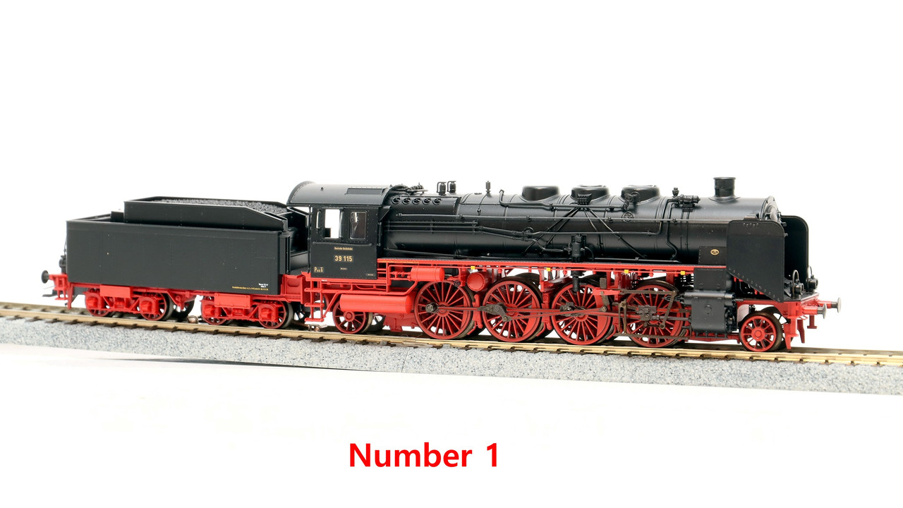

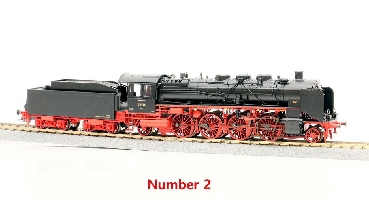

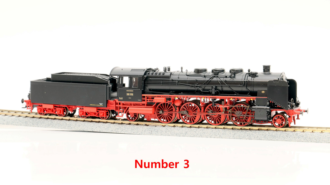

I decided to experiment with an LED lamp and some flashes. Equipment is a Canon 90D with two Canon flashes and an LED spot lamp. All images taken with Aperture Priority on a tripod. An 18% grey card was used to set exposure.
1. The first image is with the LED lamp and one flash pointed up at a white ceiling.
2. The second image is with the LED lamp and two flashes. Both pointed up at the white ceiling.
3. The third image is with the LED lamp and both flashes. The main flash is pointed up while the second is now at 45 degrees pointed back into the ceiling corner (white ceiling and a china white wall).

All three look OK to me. But my preference is number three followed by one. I was fun playing around and thought I'd share my experience.

Posts: 4,161
Number one is blacker with the best contrast.

Hi Ken,
#1 for best blacks.
The photo will look better if the drive rods are at the 6 o'clock position.

#4 Posted : 03 February 2026 22:29:31(UTC)
rhfil
Joined: 05/09/2014(UTC)
Posts: 837
Location: NEW HAMPSHIRE,
The wheels in #3 have a little less shadow. You should include info on the lens you used and the speed and f stop setting. Nikon had an interesting ring light for macro photography. I usually find led's to be harsh. Did you find a way to soften the light? But regardless the photos look great.
