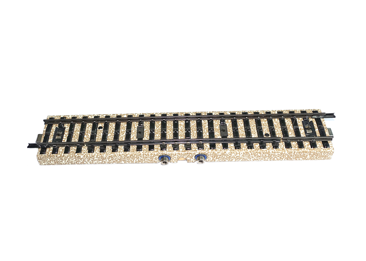

No,we are discussing these
The ones you mention are the 5146, 5147 and the wide radius one 5213.
Those are working perfect PROVIDED noone tryed to "adjust" them without removing first the transparent lever.
Also key, when reassembling them to leave a little lateral play so that they NEVER touch the stud line (and thus get stuck)

THe 5146 / 5147 / 5213 are very finicky and not very reliable after they have been installed and used for a while.
I replaced all of mine with the 5104 and 5105 contact rails.
They work like a charm, you just need lo leave enough space so that a train will not stop on them.
The 5146 only get activated by a slider, the 5104-5105 get a jolt every time that a set of wheels goes over it, so with a long train that gives you at least 25 attempts to get contact.
