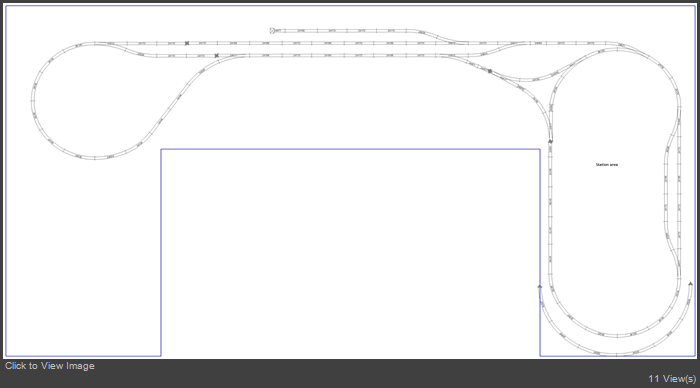

Hi all.
My name is Felippe and im about to order my first modelrailroad starterset. Märklin digital H0.
This will be my first time with modelrailroading, im a scale modeler And i wanted to do something more interactive.
Im playing around with SCARM and trying to learn it and But i have some errors. some pieces dont line up exactly.
Thank you.

Hello Felippe,
Welcome to the forum. I used SCARM to design my layout, Immensee, also a topic on the forum. Don't worry about small misalignments. There is enough "play" in the track that will allow assembly.
Roger

While some misalignment still can be made to fit without problems I'm a bit worried about the gaps on the left side of the layout. I have done a lot of fiddling with scarm to make ends meet in creating and changing parts of my layout, and it often took quite a lot of experimenting with all sorts of small bits and pieces to get a good fit and a nice looking shape.
Sometimes you succeed with almost impossible things. Sometimes you have to reevaluate everything and come up with something different.

Thank you. I will have a check to see if i can get the gaps alittle smaller. Atm im playing around basicly adding a wye and a reverse loop to the starter pack. My thought process was that to have the train able to take some different paths. Writing this i just realised i might not need the wye to make the train go left or right in the right area...

There is a lot of thinking and planning going on when making plans for a layout. One sits and looks at the picture and imagine how the trains will run from place to place and in what directions. Having a wye looks great (I only have a couple of reversing loops incorporated myself, one of them to be able to back train consists into staging tracks). The loop on your left side could be simplified if only a single track led into it. Lots of fun involved in the planning phase.

Good points. Will look into it. The plan is to move the loop further down on left side as i get more experience and track and later on close the area at the bottom so i can have a train run around the whole layout but to spare a square hole in the middle to be able to reach things.
where the right leg ends is at a door but ive got like a door width and then an aditional meter of the room. (my english aint the best) So i have still room to stand and run the layout.

Uses SCARMs measuring function for exact gap length. Track calculator tells you what pieces needed.
https://cabin-layout.mix...ngth-calculator.html?m=1
