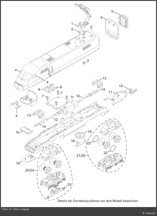

AFAIK the 36712 has already a 4 axle drive with 2 traction tire on the rear bogie so with clean wheels and rails and plastic cars it will be OK.
This is a compromise by Märklin to provide good current pick-up and reliable occupation detection already by the front bogie.
Just, periodically clean the wheels and tires with a cotton bud and Isopropyl alcohol
Here is the exploded view of the unit you consider purchasing (with two traction bogies and a central motor
To increase the traction power (not sure you need it) you may order a rear drive bogie E108 048 (30€) but flagged in yellow (not immediately available so better call Märklin shop)
https://www.maerklinshop.de/search?sSearch=E108+048+

The Marklin website refers to 2 axes powered, that’s part of the confusion, the drawing stipulates the details may vary.

You are sadly correct. Märklin has removed some part to lower their cost.
Must see if in reality the motor is fitted
One wild gamble is your idea: how about adding a supplemental rear bogie to the front with the following issues to adress
- negociate with M to obtain a supplemental rear bogie
- get a new transmission shaft or make one I think both transmission shafts are identical. Märklin describes them as Kardanwelle E216 777 €7.50 for two shafts and in stock
- adatpt a slider into the extra rear bogie. Chances are the same bogie frame is used on both the front and rear ones so only a matter of moving or adapting a small contact plate to collect power from the slider
- make sure the existing motor is fitted with a transmission joint on both sides
An interesting project
