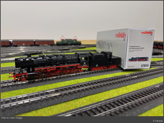

I have the new Märklin 051 lok (37814) that comes from factory with a buffer capacitor. I'd like to swap out the factory decoder for an ESU LokSound5 decoder. I just don't like the way Märklin does their steam sounds. Does anyone know if I will be able to program the CV's needed for the buffer capacitor into the ESU decoder?
I compared the buffer capacitor CV's of the lok to the CV table of the stand-alone buffer capacitor 60974 and not all of the CV's are listed on the lok (at least from reading the lok on the CS3). Does anyone have any insight to this?
Here is the lok in question:

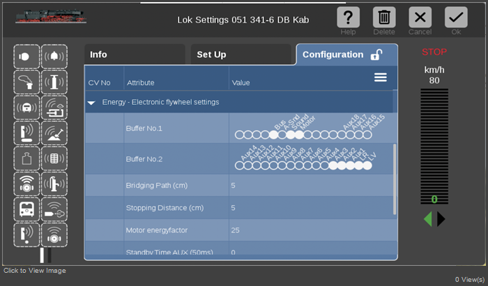

I guess Märklin forgot to add this detail on their website as well as in the instruction manual included with the lok. I can assure you, this lok definitely has not only one, but two buffer capacitors in it. Buffer 1 is for sound and motor and buffer 2 is for lights and AUX outputs. When I cut power to the track, the lok keeps running for a second or two and the sound continues.
Plus, you can see in the lok's setup menu on the CS3 that the capacitor is labeled as an "electronic flywheel":
I don't know why Märklin didn't announce that this lok has a buffer capacitor...

You are probably right, and the locomotive has a buffer capacitor. But if it has two?, they are probably linked. The menu probably only refers to configuration setting 1 and configuration setting 2, not separate capacitors.
One setting I notice is that AUX 4 is always on, and AUX 4 is configured to the Voltage buffer control setting.
So you need to check with ESU, regarding compatibility.
You're correct about the lok only having one capacitor:
I thought it may have been the same setup as the 60974 add on capacitor from Märklin:
thanks 1 user liked this useful post by Dirtboy
