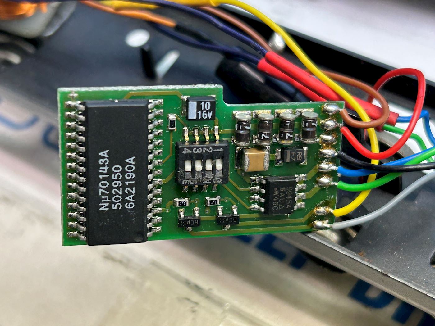

Hello
I bought a used 3075.
Contrary to the ad, the machine was in poor condition (a missing bogie, etc.).. but I have parts to repair.
When I opened the machine, I saw that it had been digitized.
I wondered...
To switch it from digital to analog, isn't it enough to set all the switches to zero?
There are four switches: two are already set to zero, and the other two are set to 1 (the positions range from 0 to 2).
Of course, there is no documentation.
NB: I don't have any other photo besides this one... which I used for the dispute... as the machine is being shipped back to me (the seller refused to take it back).
Thx
Phil

Phil
That lok is a #3021 (V200), not a #3075 (BR216)
It has what seems to be a Delta decoder
Yes, switching all the switches to 0 will make it drive in analog mode
Jean-Pierre

Yes, you're right is a V200. I always make a mistake with my BR216 I also own.
Tx. will lower all the switches to enable analog
Phi

As the decoder has only four switches it is an early Delta decoder - not the earliest version which had solder jumpers to set the address, but the next generation that came out after Marklin decided not to use the automatic analogue mode sensing that they were in dispute with the patent holders.
