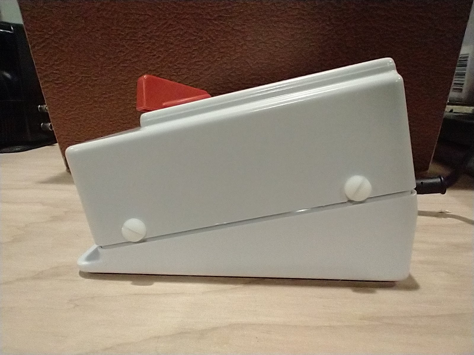

I removed the plugs using the method outlined above. However, when putting things back together, I used four 8-32 x 1/2 nylon screws purchased from a local hardware.
thanks 4 users liked this useful post by marklin81

Do the nylon screws fit flush against the case? Only because if not, and you want to clip it next to another trafo, or a 6021 control unit using the clip slots on the bottom, the screws may not allow enough clearance. The model kit sprues look lie the factory plugs except where t the paper label has the new hole.
