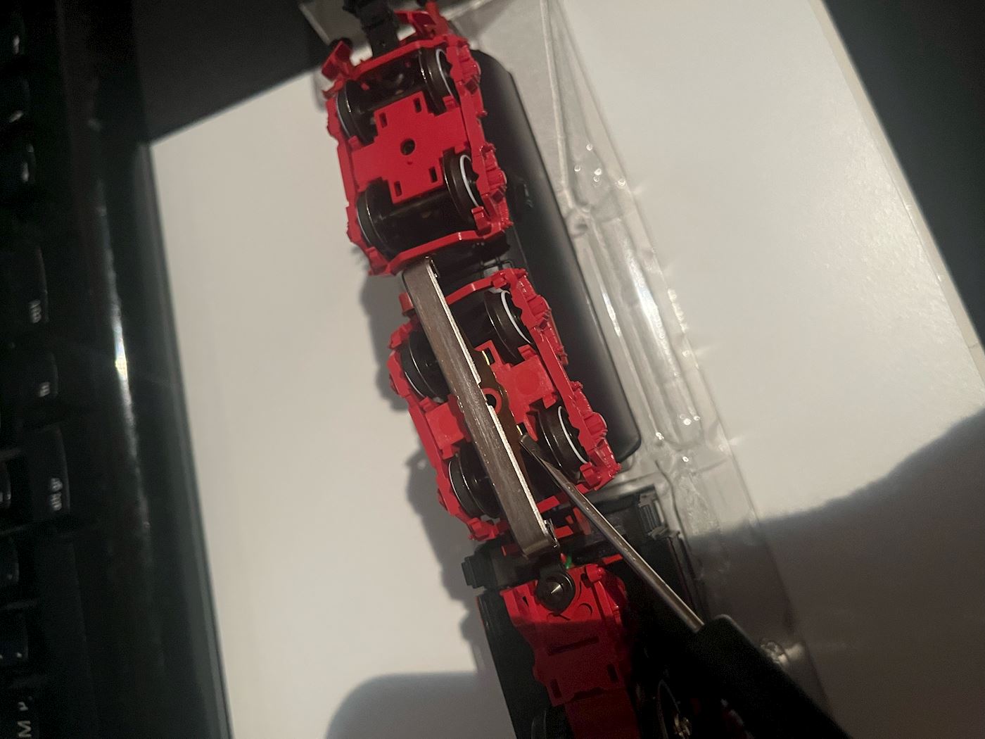

image0 (13).jpegimage2 (6).jpeg Here are some pictures of the pickup on the tender and the instructions showing how to open the tender.

Thank you for the answer! I am still a bit unsure where I am suppose to put the screwdriver. Where is the ”upturned toe of the slider”?

Both ends of the slider are "upturned" but the decoder is in the tender. There is a round hole in the center of the tender. The screw should be in there. Once you remove it the top of the tender should lift off revealing the decoder. Do you not have the manual? There should be instructions in it to access the decoder and how to set it.

Are you refering to this spot where I am pointing the screwdriver? Sorry, I am sure that you are describing this well and that it is my language skills that are making it hard to follow

Are you refering to this spot where I am pointing the screwdriver? image0 (14).jpeg Sorry, I am sure that you are describing this well and that it is my language skills that are making it hard to follow
I just think I understod what you are refering to (I get that the part that I am point to is wrong!). I did not know that you could remove the part of the slider that is touching the rails from the leaf spring. So I need to bend the metal part upwards to remove the slider?

The bending part seems quite tricky... The instructions show this image image0 (15).jpeg of the entire slider being removed but gives no instructions on how you are supposed to do it. Does anyone know how to remove the entire slider? I am a total novice when it comes to this stuff, as is probably obvious.

Just pry the whole base plate out. The red plastic insert pops out with the slider attached. The frame that goes around the wheels (bogie) stays attached to the tender until the screw is removed. Just the center piece where the slider attaches pops out.

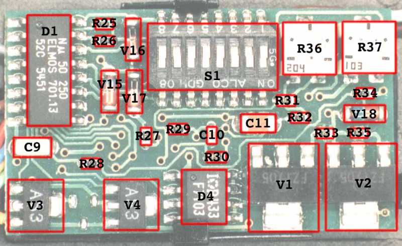

As far as I could tell, this is a digital locomotive with a 6090 decoder. Inside the tender, it should have a decoder with a 8 dip switch assembly that will allow you to select one address between 00 and 80.
https://www.pallund.dk/marklin/6090x/6090_up.jpg S1 = Dip Switch Panel
Looking at the underside, I don't see the modern slider with plate. I see an older version that is clipped into the red base where four metal tongues are bent into the red base. As you stated, there is no hole in the slider, making it more complex to insert a screwdriver into the screw beneath it.
To do this, gently tilt the slider either to the right or the left and use a thin jeweler's screwdriver to unscrew the screw. Do not use a large screwdriver or force the slider too much.

This should be the factory decoder in the 37159
