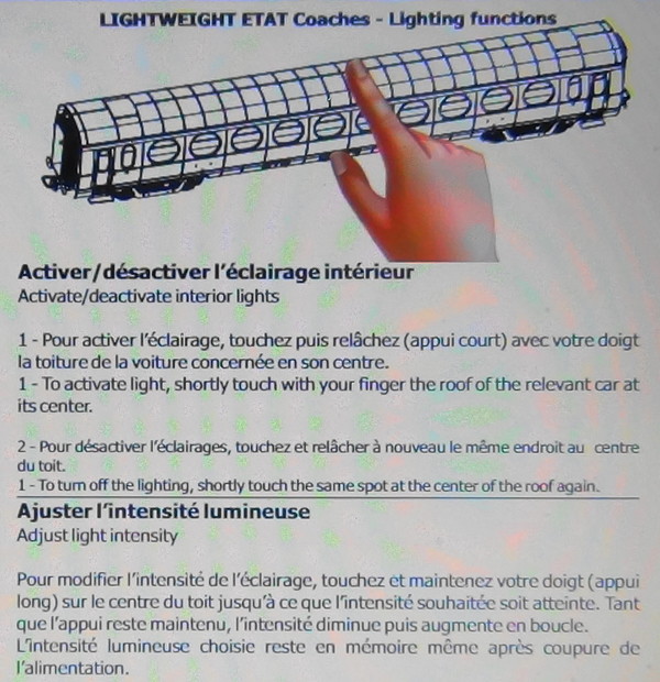

#2 Posted : 20 March 2025 04:27:02(UTC)
Posts: 8,369
I found this on YouTube:
I guess that you would have to leave one contact to the axle/wheel and wire the other one to current conducting couplers and mount the slider on one of the coaches or take power from the locomotive.
If you put a decoder in one of the cars, you would need to run two pole current conducting couplers for both live and return.

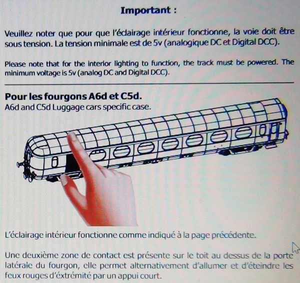

#7 Posted : 21 March 2025 03:04:28(UTC)
Posts: 8,369
Other than the two pages I posted, were there any other instructions that came with the models?
I decided to search using French terms. Perhaps this will help:
Offline Normmeister
#8 Posted : 21 March 2025 03:22:37(UTC)
Normmeister
Joined: 15/04/2011(UTC)
Posts: 54
Thank you Mike that is exactly what we needed !!!!!
There were NO instructions at all with the coaches. And our search in English did not reveal the "how to turn on the lights" that you sent earlier, and since we had no instructions, did not know about that .
thanks again !
Norm.

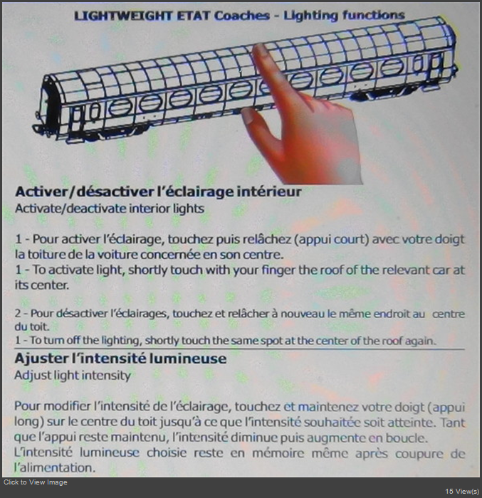

Offline Ross
#9 Posted : 01 April 2025 05:53:49(UTC)
Ross
Joined: 25/09/2006(UTC)
Posts: 973
Location: Sydney, NSW
Hello Norm/Mike /All,
My friend Oliver's Ree VB-475 coach set how to get the car apart photos.
The first problem to tackle is to remove the buffers and this isn't as easy as the video shows.
There isn't much space for people who might have sausage fingers to be able to grip the buffers with ease, I found that if I used a small flat blade screw driver and pushed the buffer from behind to budge it just a small amount then try using the fingers for final removal. This isn't for the faint hearted to attempt getting the car apart.
The photo above shows the body shell removed which allows you to see the partline shape. You have to squeeze the body shell on both sides starting at the first round window and rock sided to side then select the next window and repeat. You will notice the partline starting to come apart. Dont squeeze close to the ends of the car as it is very rigid.
This process requires firm squeezing at the location of the rectangular holes on the mounting tabs. I wasn't in my comfort zone doing this procedure.
Side view above of the body with light switch in the middle.
The next view is a top view of the lighting PCB
A close up view showing the diode bridge and control components on the PCB
Close up of the body shell showing curtains, very nice.
The aim is to convert the coaches from 2-rail to 3-rail to be able to run on a Marklin digital layout. While the coaches are being modified to have single pole electrical couplers added to be powered from the locomotive, passengers will also be added at the same time to try and avoid opening the coaches multipule times.
More to follow on this topic when time permits.
