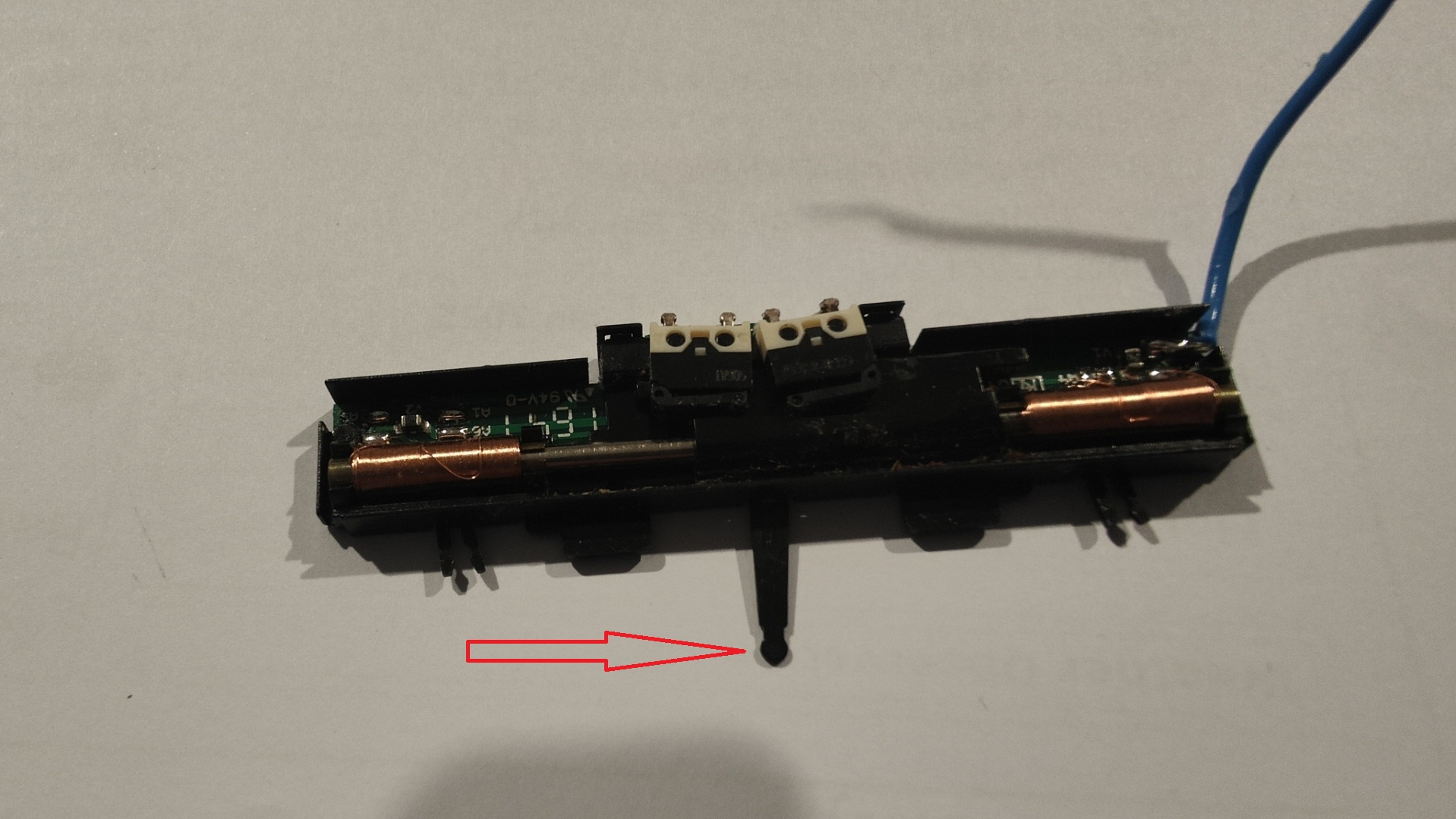

IMG20250128062914.jpg shows what I have
IMG20250128062926.jpg Solinoids are working. The Tongue arrowed moves in and out as they are meant to.
IMG20250128063107.jpg The levers arrowed will work in one direction but not always back again.
This leads me to believe there is a faulty lever inside. May have come off its mounting or the movong part of the point is sticking somewhere.
Are the points themselves serviceable?
Can you get in the back of them & if so how?
As I said it is not the point motor that is the issue. It is the mechanisum inside the point.
Trevor
thanks 1 user liked this useful post by Trevor G

Hi Trevor,
It looks like you are using a standard curve point 2262 2263.
The points are not serviceable.
The point motor must be flat with the track bed not raised or lowered.
Have you tried a different point motor?
The size of the point motor tongue can vary, if you have several motors measure them until you find a different size then try that.
Make sure ther are no flash marks on the tongue as these can catch and stop the point working.
If you have a manual hand lever remove the tongue from the mounting and use it to test the point movement. Your fingers will feel if there is any catching or stiffness.
If the point blades catch and the movement in the point mechanism switches then the surfaces around and under the point blades need to be cleaned.
If the point mechanism catches ensure there isn't any rust on the metal surfaces.
As a last resort use a dry lubricant such as teflon powder don't use wet lubricants!
Hope the above suggestions help track the problem down.

You have the newer, less reliable K track switches. The new ones look far more prototype and less massive but are far less reliable. Several sthoughts for you:
1. The solenoids have a little plastic tab that sticks up and moves fully right or left when the solenoid works correctly. If one side of the solenoid is not getting enough power, you will find the little tab is not all the way over and the points are not all the way opened or closed. This is the typical problem with K track switches.
2. If you do not have the points right when you slide the plastic tongue from the solenoid motor into the switch it wont seat right and your switch will not work properly. The plastic tongue has to be fully extended and the switch points have to be either fully opened or closed (I can't remember which) to seat the tongue properly in the switch.
3. If you pull a failing solenoid motor from its track position and test it by directly connecting it to the auxiliary ports on your transformer it will usually work fine, but when reinstalled on your actual layout it will not get the same voltage and will fail to close completely in one direction (at least that is true on analog set ups).
thanks 1 user liked this useful post by FastEddie
