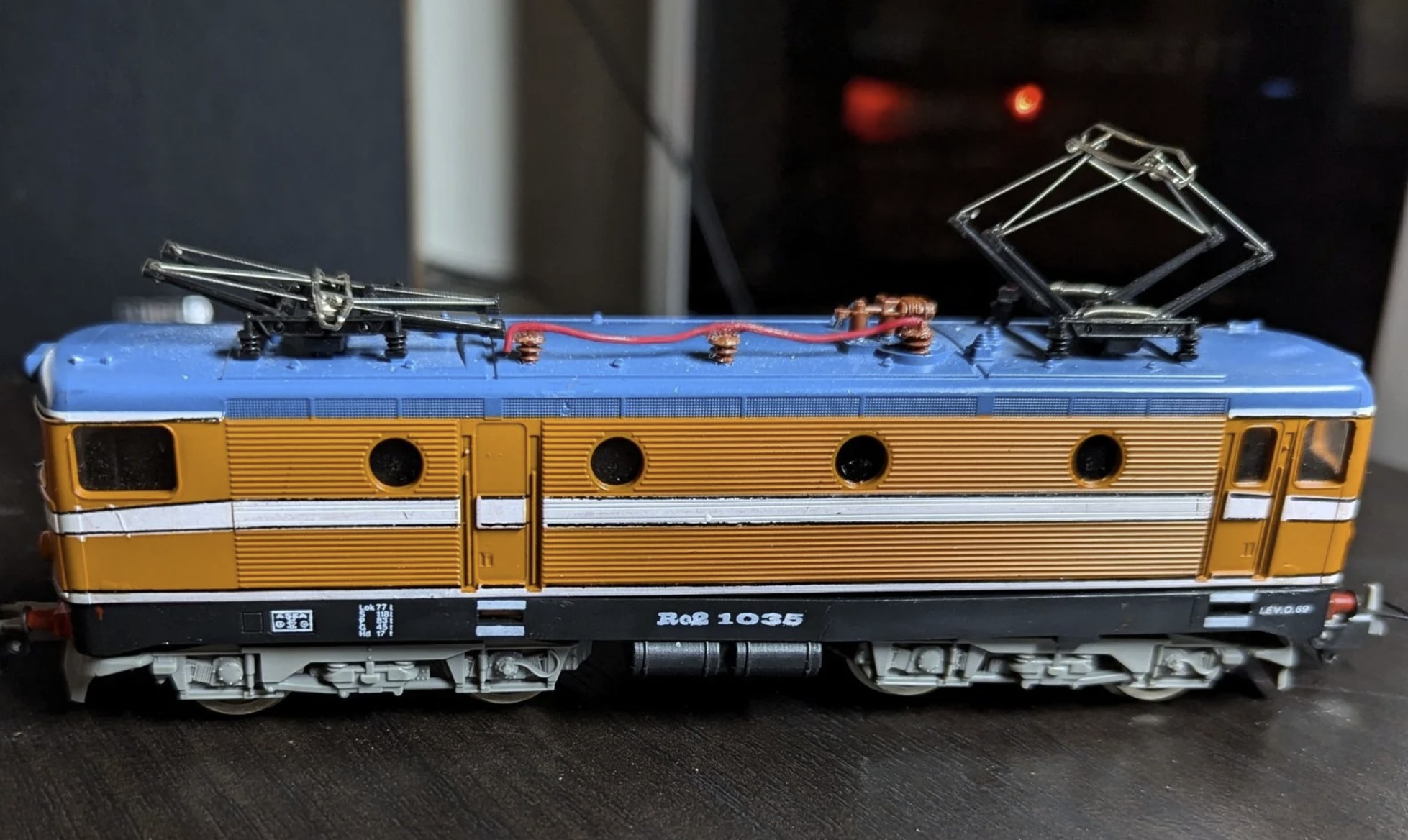

Offline jonas_sthlm
#10 Posted : 23 January 2025 19:10:05(UTC)
jonas_sthlm
Joined: 12/10/2008(UTC)
Posts: 1,020
In my personal opinion, the Roco model developed in 1982 holds up better details and painting (especially lines) than the ones Märklin come up with today.
Let's hope that Märklin plastic electrical wires on the roof doesn't start to catch up with Lima Glare
