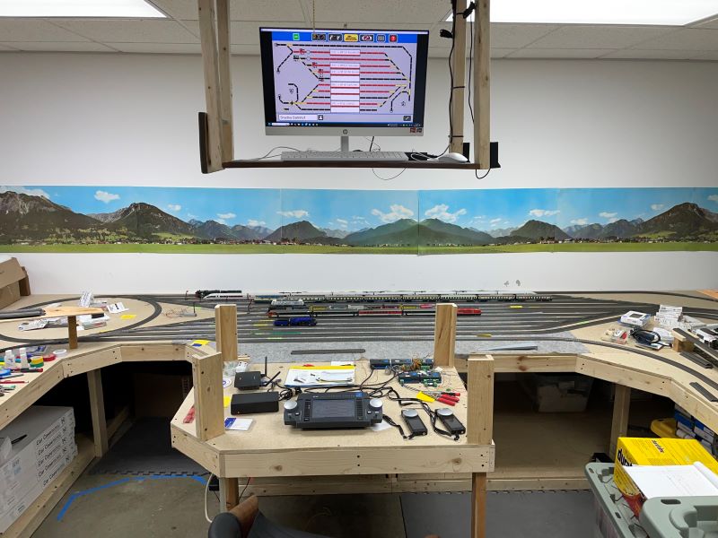

I have spent quite a bit of time lately with track monitoring and the ECoS Command Station track plan/Diagram.
I purchased the ECoS Detector RC (RailCom) and the ECoS Detector modules. It was a pretty simple setup after the wiring was complete, just one wire to each isolated track section and in the white block on the track diagram the Locomotive address & name are displayed - very cool! This will be great since I plan on having my shadow station mostly blocked from view.
Finally figured out how to display the Command Stations screen on the Laptop & TV. I can better see the track plan & train identification information. This has brought things to a different level for me.
Thanks to Rudd's Video explaining how to incorporate the VNC Viewer (link Below):
https://www.youtube.com/watch?v=hARmTlATIyE
For an early Christmas present - I set up a touch screen so I can view the track plan on a larger screen as well as being able to touch/control the switches, routes & signals... so far so good.
thanks 8 users liked this useful post by White Buffalo

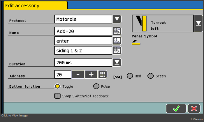

On 4 of the shadow station sidings (furthest from view) I installed the ESU braking modules using the ESU Switch Pilot & Switch Pilot Extension. On One of the stations I used a Märklin Signal/Braking module - I did this since the ICE-3 Sets (37780 & 37783) have Märlkin decoders and I did not know or understand if I could get these to react to the ESU braking modules. Perhaps there is a way to change the CV's so I can get them to react to the braking module commands.... not sure, still learning. Recently, Brian Morgan on Märklin Bar & Grill has helped & taught me a lot about these systems and how they operate. I am very grateful for that.
So, my first question/request is - Can I get the Märklin decoders to react to the commands from the ESU Braking Modules?
Perhaps I could change CV's 253, 254, 134 and 27 on these decoders? Not sure if the Lokprogrammer or ECoS Command Station has the ability to do this? I am probably missing something and I have a bad habit of making things more complicated than they need to be. I do Have a Uhlenbrock Intelibox - perhaps I can use this to accomplish that?
Any assistance would be greatly appreciated.

Or as Rick Sinclair from Märklin has taught me recently - perhaps I am making this to complicated for the shadow station and should use the Märklin K83 or M83 to control/block the shadow sidings and not using the Braking modules in this area?
I keep reverting back to the ESU Switch Pilot & Detectors since I would like to have the locomotive identification in the shadow station.
as usual - making things more complicated for myself...... thoughts or suggestions?

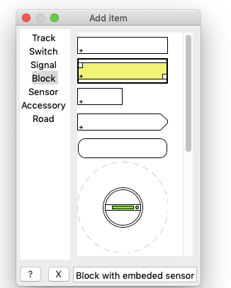

I did make some progress tonight. It took me some time to learn how to navigate through the software, but the Rocrail instructions and some help from YouTube videos I was able to connect Rocrail to my ESU and it easily populated all the locomotives & addresses. I was able to control the locomotives with Rocrail and both my ESU Hand Controllers, very happy about that! Then I added a couple of Locomotive images as well.
I'll keep moving along with setting up a track diagram......

another question,
Rocrail uses .png images and the ECoS has them saved as .bmp files. Is there a way to import locomotive images from the ECoS or do I need to add them each individually?

Looks like the best way is to save them in the Rocrail/images folder 👍🏻

Originally Posted by: White Buffalo Go to Quoted Post
another question,
Individually. You can store in any folder, and tell Rocrail where to look for them. Beware of image dimensions 230x80 and format (may need crop).
Ben van der Pluijm--

Just an update and adding some info for my records if I need to refer back. Making progress now that I have become familiar with Rocrail and better understand how to make blocks & routes. Thank you all for all of your help.
One big change was to remove the ESU braking modules since they would only work with ESU decoders and I didn't want to have dedicated sidings for locomotives with Märklin decoders. So now I can have Rocrail take control of stopping any locomotive in a precise spot prior to the signal mast. I was able to use the already installed ESU Detectors as sensors in Rocrail and now have both track occupancy and locomotive identification showing in Rocrail and on the ESU Command station track plan. I'll save the ESU braking modules for other areas on the layout.
Thank you for all the technical advise & help, I would not have gotten this far without it. Now, it will take me some time to wire up the signal mast (lights only - not used to control track power) and use some Märklin K84's and the 1 ESU Signal Pilot I have. Rocrail is a very powerful & comprehensive train software program, still learning how to use the BBT (Block Brake Timer) and develop some more complicated routes. JohnJean & Martti gave me some great advice - start with simple, take good notes and add to the track plan like in the Wiki Demo. The demo plan & virtual mode is definitely the tool I should have spent more time with from the beginning. It would have saved me a lot of time and frustration. I am still able to control the locomotives manually with the ESU Command Station and the ESU Mobile controllers, each device reflects the speed and function changes that the other makes. Looking forward to getting this first level all wired up and start on the next sometime soon - I hope BigGrin

Rocrail Block images (imbedded sensors, block colors & states, etc).

setting switch addresses :
on the ECoS - navigate to signals & switches.
Select - edit/properties tool (wrench symbol bottom right of screen) then select the desired switch.
When in the "edit accessory" screen - it will show the address information needed by Rocrail - the address in brackets on the address line.
In the example below [5:4]
Rocrail address = 5, Port =4
Duration 150 ms seems to be enough to flip the switches, perhaps this will extend the life of the switch motors
