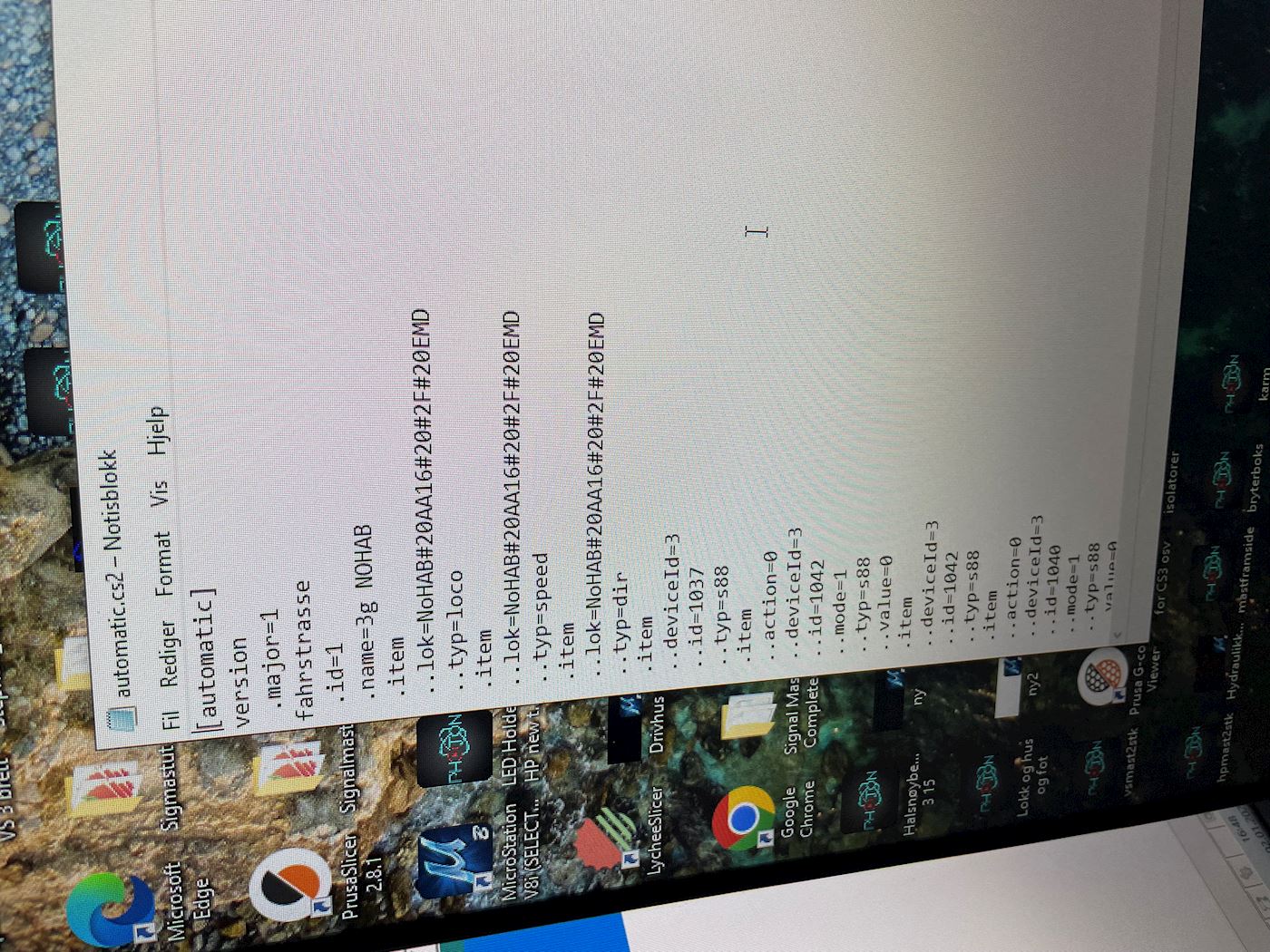

I got an idea and opened the back-up files from CS3 in notepad.
Did no quite understand the logic in the filing system. Possibly a mix of abreviations of english and german. Nevertheless I found a text file I could recognize from one of my events… listing all the commands as text. However I am not a programmer, but even I can recognize e.g. A speed command, assume I could cange the speed, save the file and restore it back to CS3 with a modified speed in the event. But as said: just an Idea… have never tried it.
Thor
Offline Tie
#7 Posted : 02 January 2025 17:02:08(UTC)
Tie
Joined: 28/09/2019(UTC)
Posts: 119
Location: Rogaland, Haugesund
Screenpic from file. Lok name NOHAB
Thor
Offline Tie
#8 Posted : 02 January 2025 17:14:09(UTC)
Tie
Posts: 119
I start all events wit setting lok speed to zero. (Safety?)
Then in text the event will look for required blocks for route to be free, and when free set it to occupied. When all required blocks are reserved for the loco, the event will sett required turnouts correct and then issue a speed command.
Assume this is the S88’s referred in the list.
When I started making these events I was not aware of the possibility to use virtual contact in CS3 so I usrd a real S88 port to define all my blocks. S88 port not connected to track. I just use event to say occupied(yellow) or free(grey).. rather expensive and uneccesary. But it worked🤣
Thor
