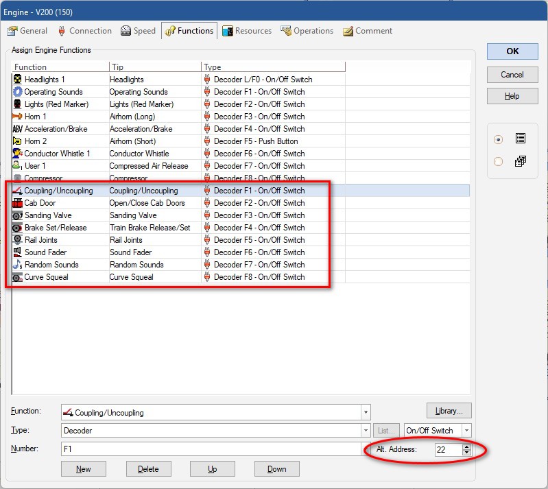

I have just finished programming and installing the LokSound 5 FX decoder in the loco. Test run was successful with F0-F4 working as intended. But...
I'm not sure how to assign multiple addresses in TC to get functions F5-F16 to work. I've never done that before. What I've done is the following:
1. Edit mode
2. Double click the V200 loco (which has address 20)
3. Select "Functions" tab
4. Functions F5-F8: "Alt. Address" (bottom right corner) = 21
5. Functions F9-F12: "Alt. Address" = 22
6. Functions F13-F16: "Alt. Address" = 23
However when I activate any function above F4 in TC, there is not sound produced. BTW, the ECoS only has F0 to F4 programmed -- the V200 is set for "Motorola 28" protocol. Not sure if this matters.
Thank you in advance for any suggestions in fixing this problem.

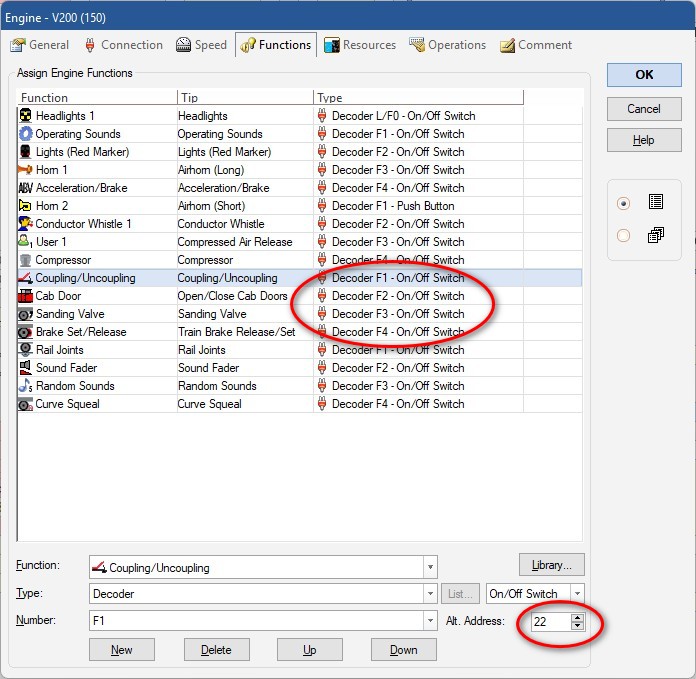

There are only 4 functions connected to each MM adress. This is how you define ”F5-F16” in TC:
4. Functions F5-F8: F1-F4 "Alt. Address" = 21
5. Functions F9-F12: F1-F4 "Alt. Address" = 22
6. Functions F13-F16: F1-F4 "Alt. Address" = 23

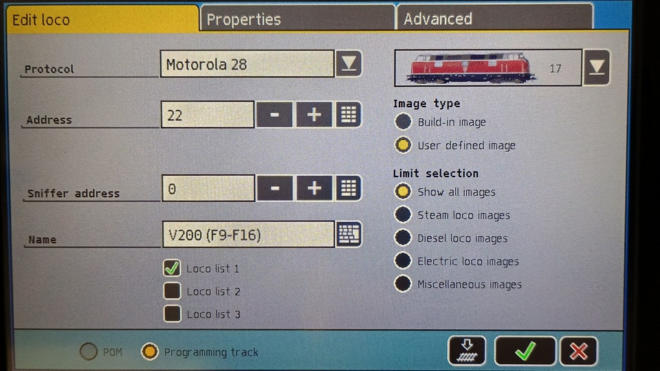

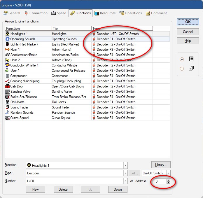

Slowly-but-surely I'm getting there. However, it still does not work right. I noticed that in LokProgrammer -- under "Address / Locomotive address" -- there is a pull-down menu for "Additional addresses". I selected "Use 4 addresses (Motorola only)". See screenshot below. Is this correct?
I also changed the loco function assignments to what you've recommended above. Please see screenshots below. Are these correct?
Thank you for your patience with my questions!

By doing what was described above, I now have four entries of my V200 in both the ECoS and TC. Each entry displays the proper function key assignment and only the first entry (address 20) controls loco movement (as expected). However, only the first entry actually activates its functions keys (F0-F4), but the other three entries don't activate their assigned functions (i.e., F5-F8, F9-F12, and F13-F16).
Just to elaborate:
1. F0 (Headlights), F2 (Marker lights) and F4 (ABS) are the physical controls from the original Marklin motor decoder -- these work fine;
2. F1 (Operating Sounds) and F3 (Horn) are sounds from the LokSound 5 FX decoder -- these work fine (very nice sound).
Problem: Nothing above F4 can be activated. Any help would be welcome.

Background: I use the ECoS only as a "command station", i.e., to send multi-protocol digital signals to the layout. I use TC for control of the layout. My accessories are all DCC and my locomotives are a mix of DCC, Mfx, and MM. I don't have anything programmed into the ECoS, except locomotives. The default protocol in the ECoS for new locos is "DCC 28" and for new accessories it's "DCC" (see picture "ECoS Setup").
Because the V200 has an MM decoder, it does not automatically register in the ECoS. Therefore, I used the ECoS "new loco" setup menu and entered my loco. It came out as "Motorola 14", address 20 (see picture "ECoS - V200 Address 20 (MM)").
When the LokSound 5 FX decoder was entered into the ECoS, it automatically was assigned the DCC protocol because of my ECoS defaults (see background info above and picture "ECoS - V200 Address 21 (DCC)").
Once I corrected this problem, I had access to the FX decoder's function keys (see picture "ECoS - V200 Address 22 (MM)").
Problem solved!

The ECoS allowed me to assign 8 functions under the V200 address 20 (MM). Because of this, I only needed one additional V200 entry in the ECoS to control function F9-F16. (see picture "ECoS - V200 Function Keys").
The addresses used are "20" for the original C-Sine motor decoder and "22" for the LokSound 5 FX decoder. I'm not 100% sure why that is, but maybe because MM decoders only had 4 functions, the ECoS uses two addresses for each set of 4 functions (i.e., 20 and 21).

In TC, I only imported the main loco from the ECoS, using "Train / Loco Database in Central Unit". Because I programmed the LokSound 5 FX decoder as having 4 addresses (see below), only one loco is required in TC to control the motor and all 16 functions. Great!
Below are pictures of the loco "Function" screen. Note that I only use address 20 and 22. ("20" is shown as "0" in the "Alt. Address" field because it's the default address programmed into the decoder -- see picture above). I'm pretty sure that TC uses successive addresses for each decoder to access all 8 functions in each respective decoder (because of the MM format limits), and that's why four addresses (20, 21, 22, 23) are required to access all 16 functions. (Just my speculation).
