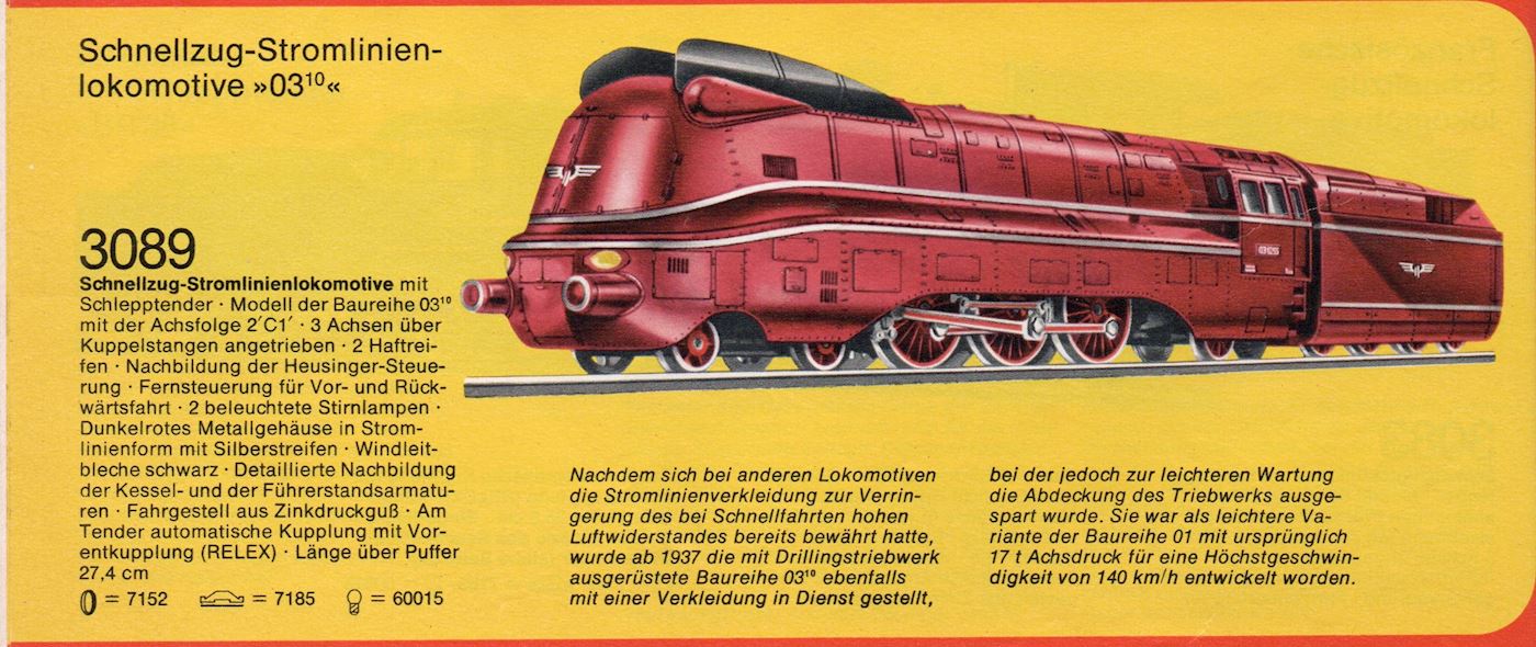

I recently replaced the tires on my Marklin 3089 Red Baron BR 03-10 with new 7152's and they are really stretched tight on the wheel. Enough that at some places the rubber is very narrow. Didn't seem right, so tried some from a different package and same result. The expanded parts diagram I have for the loco show these to be the right tires. Did I get a bad batch of tires, did the size change from when this loco was made to present, something else to consider?
The loco was unable to get traction climbing an incline that my other locos have no problem with. It seems like it has plenty of power but just not enough grip.
Help is much appreciated.

I checked in all my catalogs, it is indeed the reference 7152 which is indicated.
I don't have this model, someone who has it here could confirm this.
Or there is a packaging error...

Most passenger steamers with 3 large driving axles take #7152, including my br10. I have #7152, 7153, and 7154. The other 3 are all smaller than #752
