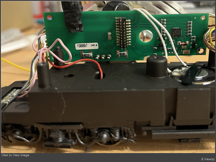

I'm replacing broken decoder of https://www.maerklin.de/...ts/details/article/37349 with mSD3 21-pin.
There seems to be no sound project available for #37349 so I tried #37301 project. However the lights seem to have a setup I'm not sure how it works. There is propably some logic in the PCB for the long distance lights as the light boards only have one white led per side and three red ones.
So does anyone have a working project for #37349 to share with me please?
I could always try to get rid of the PCB and solder the lights to work with just normal AUX outputs instead. Not sure how I'd implement the long distance lights thou... Headlights + Aux1 to the same LED?
Also some explanation on how the SUSI works, would be nice. The #37301 I'm using controls red marker lights and long distance lights with SUSI but headlights with normal headlight outputs (which don't work on the PCB either)
Thanks!
-Eino

AFAIK, among all my Re 4/4 II, only the projects of 37359 (green) and 31016 (Gottardo) come very close to that of 37349. Sound allocation just differs slightly.
However, 37359 has no long distance lights, and has a different light pcb.
31016 and 37349 both have long distance lights and share light pcb #E198895.
For the other recent Re 4/4 II with drum collector motor, 37351 (50y LGB; no long distance lights) and 37306 (Zugkraft Aargau; w/ long distance headlights), which share another light pcb #E253056, a sound project is available at the M* project page.
Although I did not check, you may be correct that headlights/long distance lights are simulated by dimming a single led, also with this light pcb.
*Bart
Hi! Will check of there is a sound project for the 31016 and try that!
It’s a set thou. The 4/4 seems to be #268156
-Eino

I would love to download and send the decoder project from my 37349 for you, but I don’t know how.
The 37349 factory-installed mfx+ decoder (2014) is pre-mSD3, and is not recognized by the 60971 decoder programmer + mDecoderTool3, which can only read out mSD3/mLD3 decoders.
Also, while I can program the 37349 decoder with the CS3, I don’t seem to be able to download and save the decoder project from a loc – neither in the CS3 itself nor when CS3 is connected to mDT (mDT only enables the “decoder tester” dashboard for the 37349 on the program track, no decoder read-out).
This has been discussed before many years ago, and nothing has changed? www.marklin-users.net/forum/posts/t42089
Am I correct that there is no way to download, save of backup decoder projects from a pre-mSD3 loc using a 60971/mDT3/CS3 setup?
*Bart

I'm afraid the light settings seem to be a combination of pcb hardware and dedicated (SUSI?) programming.
As far as I can see in the function mapping, the light functions such as long distance lights (= brighter headlight leds), Swiss white/red tail light, triple red warning signal, are not mapped to AUX outputs, dimming settings, or to logical functions (which are not available in pre-mSD3 decoders), but refer only to a "sound" file (e.g., sound13, sound16) that is the only output mapped to the light F-keys.
*Bart
Could you please take screenshots or photos of which SUSI output is assigned to which function key and also with what settings?
-Eino
I'm not 100% sure, but I believe the susi settings are stored on the susi board, so as long as the susi functions are mapped to a function button, they should work the same way as with the original decoder.
In the lastest Cs3 software, the were some improvements related to susi cv configuration, in order to make it easier to read and change values etc.
Have you tested to see if the cs3 reads the susi board connected to the original 37349 decoder? (under the configuration tab and browse to the bottom)
I don't have the locomotive or any mfx+ "msd2" decoders with susi function decoders, so I can't test.

Sorry, there are no SUSI settings accessible through the CS3 configuration for this decoder
*Bart
