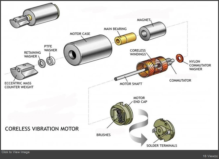

I brought up this subject with Frank Daniels, ZscaleHobo.com. He was kind enough to send me this helpful image:
thanks 2 users liked this useful post by caldude53@att.net
