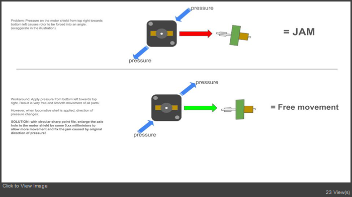

So I did find the problem and also came up with a solution!
The loco runs incredibly well now!
Here's an illustration!
-Eino
thanks 3 users liked this useful post by einotuominen

Glad you got it resolved and you are happy although the solution applied seems odd to me.
If the loco shell puts pressure on the motorshield, causing the axle to be crooked, I would think you would want to modify the shell or motorshield externally to avoid both touching, but not modify the axle hole itself. If without shell the axle is straight enough to work fine, it should also be like that with shell. Now with your enlarged axle hole you risk having too much play on the axle resulting in excessive wear/noise. How sure are you it will not get stuck again when the brushes wear a bit or something?
Have you checked the shell on the inside for marks where it touched the motorshield? Is not just some material in the way like a burr of something that can be dremeled out?
BR,
Bert
thanks 1 user liked this useful post by DasBert33

Hi guys,
good points.
The retrofit set is the correct one for sure.
The enlarge axle hole in the motor shield is perhaps 0,05 mm more. Not over a tenth anyways and it had a tremendous effect. I don't believe it will cause so much freeplay that later on problems arise. And if they do, it's most likely from brushes wearing badly. That of course is then an easy fix just to replace the brushes. This is something we'll see in the future.
I rather not dremel the loco shell as it is in perfect shape and don't want to risk any damage to it.
I've previously done all kinds of modifications like fliper motor shield parts upside down for an BR18 Delta etc, and really don't want to do that kind of modifications anymore, so doing a ~5 circular motions with a diamond file was quite an easy one this time. Yes it is a hack but for my some short experience and reading other peoples experiences, these kind of hacks are sometimes required.
-Eino
