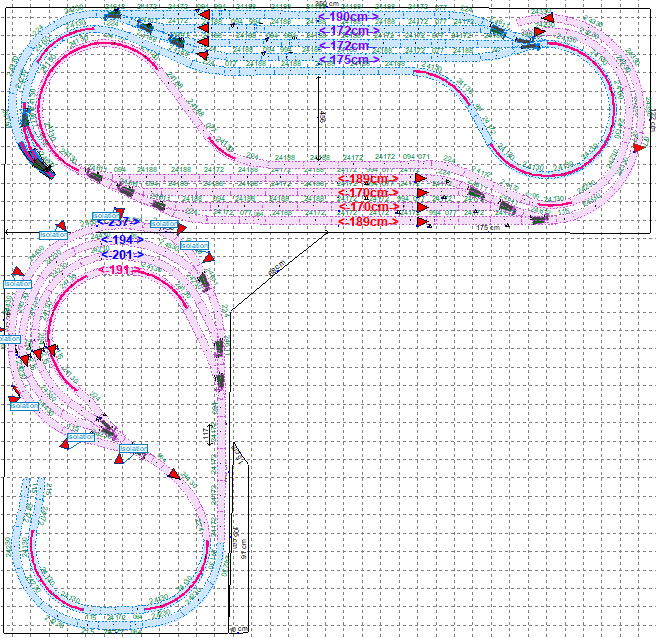

if you are so kind to continue giving me your expertise on the subject, here in attacchment is my current layer 1. Sx are signals, Tx are turnouts, FSxx are detection tracks. it is right circulation, german style.
the interrupted tracks on the lower right go on underneath in a shadow station, whilst the upper interrupted tracks are raised and continue to go down around the edges and raising to upper levels. Down center is the main station, middle center is the yard zone. there is also a ring between yard and external main lines, for a regional DB loop.
I have read the section about Rocrail sensor strategy, i think that i could use 3 sensors per block, maybe 4 on the main station blocks.
would you be so kind to share your layout, at least a piece of it similar to mine, with your signals position and detections zones, and give me an opinion on my actual detection zones strategy, which i have originally planned for usage with the CS3+ events functions & macros.
my sensation is that i have to change the last track of the detection zone of each block, which is a 236 mm straight, because otherwise the train would stop too soon. maybe i could swap it with a 64+172 (64 last), so that the train would stop a few cm before the signal. other hints ?
thx.

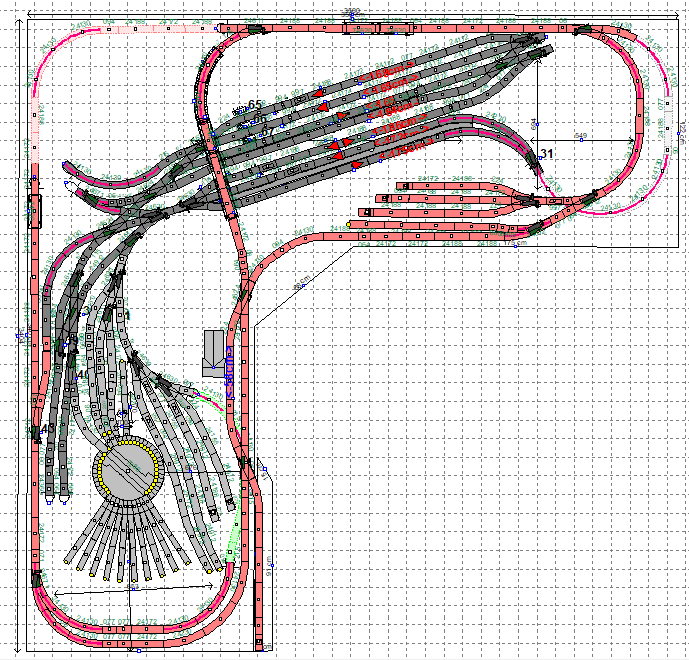

I have not such a plan. Here is my layout plan basically on 3 levels
The lower level & shadow stations
The two upper levels
The lower level and grey zone of middle level handles long trains (1.6 m) while the rose part of the upper level, handles short trains (branch line trains and bus trains (Schienenbusses)
The arrows on tracks show you if the track is one way or double way track.
The rules are the same for one way tracks: 22 cm for the IN section and the rest (until the switches) is for the ENTER section
Bidirectional blocks
- short trains: a 22 cm section for ENTER and the rest (22 cm) for the IN section. The same sections become respectively IN and ENTER
- long trains: 22 cm section for ENTER, 22 cm for the IN section (at the other extremity of the block and in the middle the section is connected to ENTERSHORTIN
One very long block, in the shadow station center left in a staging block with 7 sections. It can host up to 7 locomotives. The sections of equal length (my choice) are "used by trains depending of their length and a small security spacing is calculated by Rocrail. It works flawlessly but requires a good understanding of staging blocks (not rocket science but open air testing is advised.
