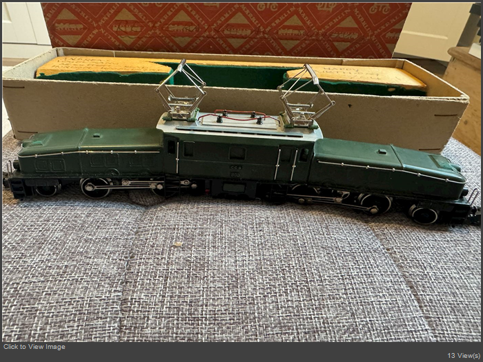

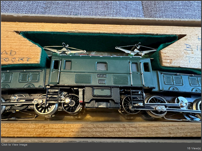

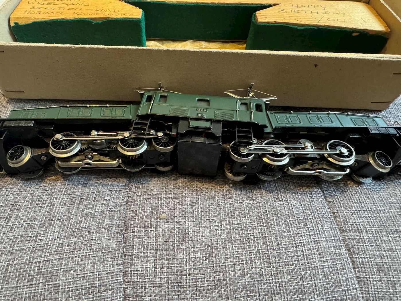

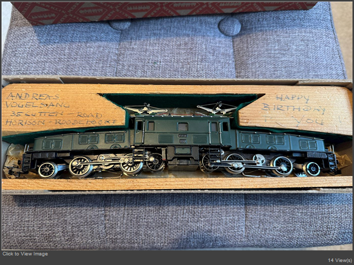

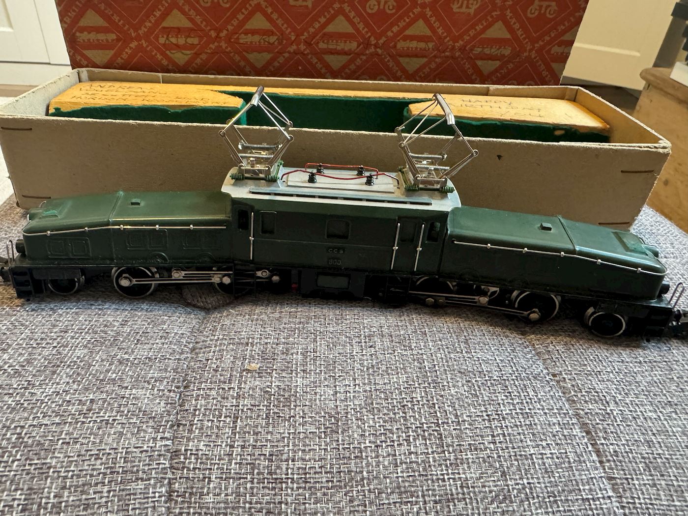

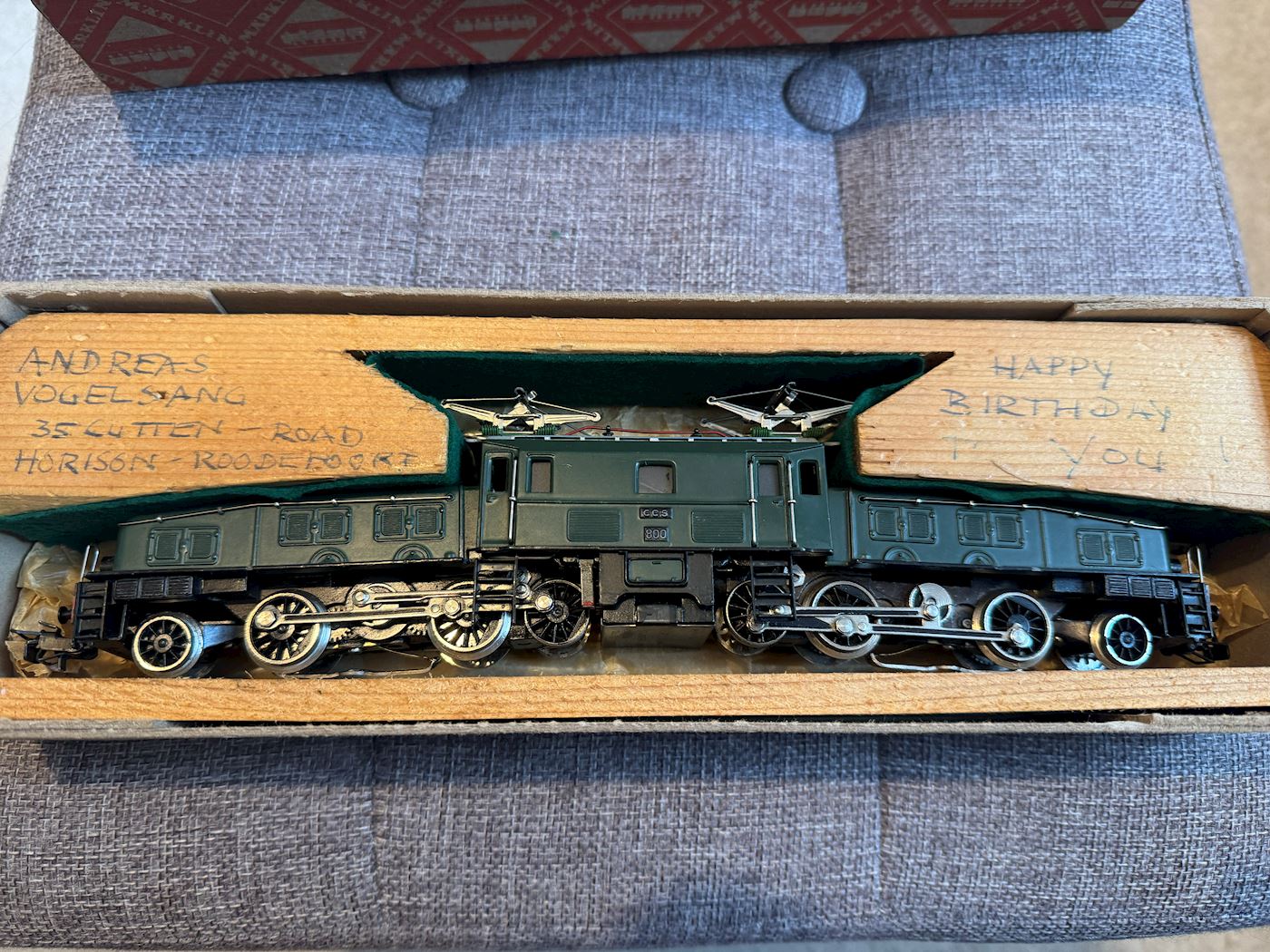

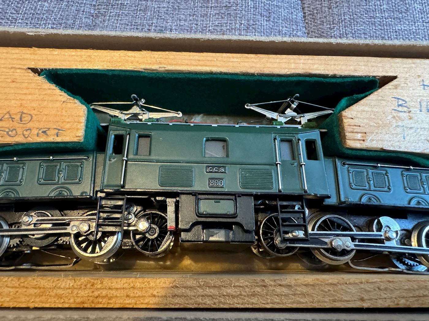

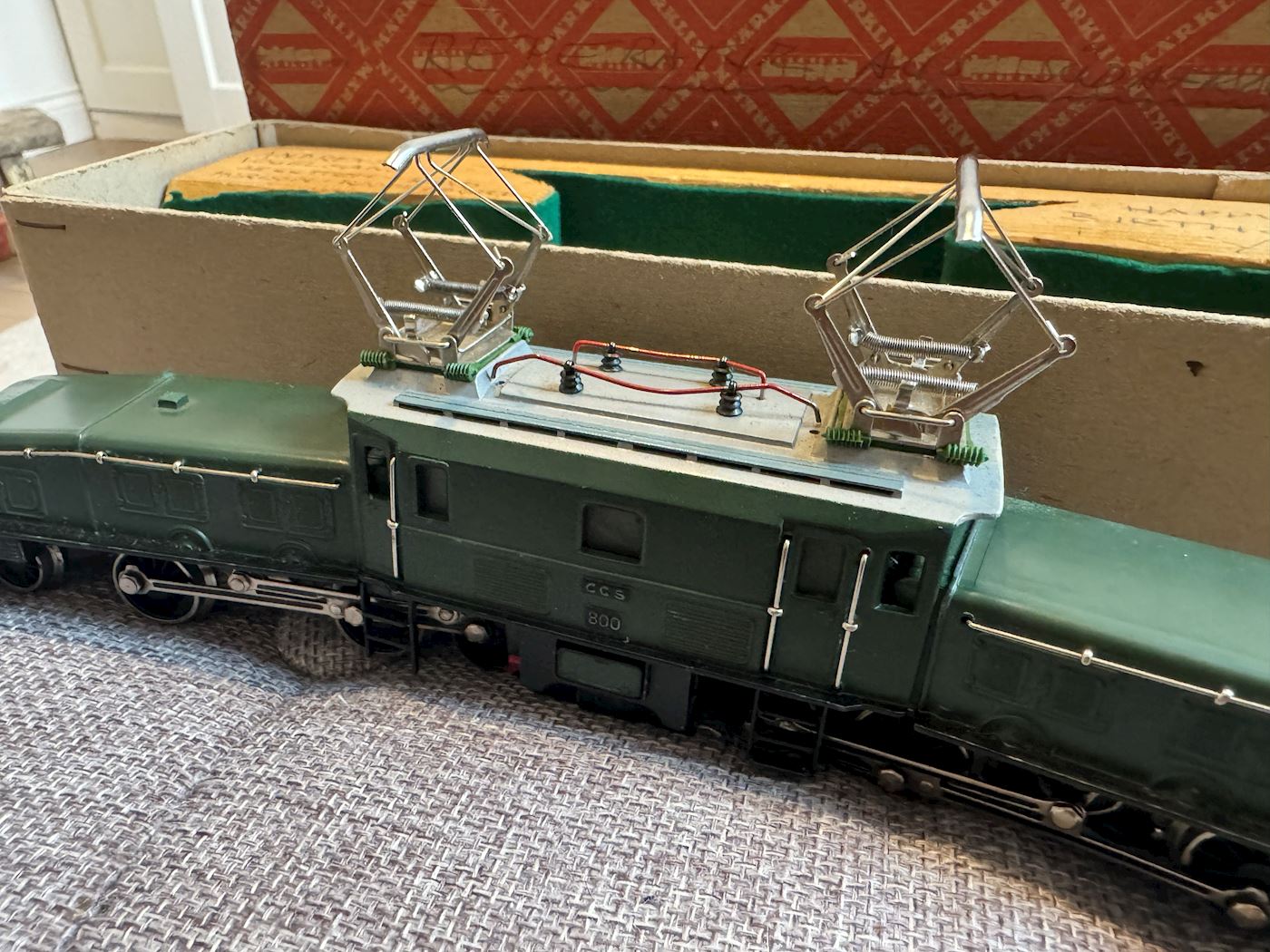

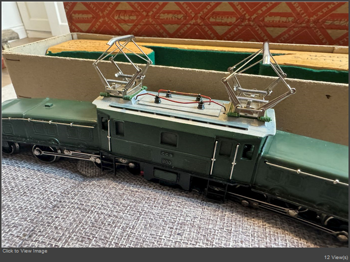

IMG_1807.jpgIMG_1803.jpgIMG_1806.jpgIMG_1805.jpgIMG_1801.jpgIMG_1802.jpg Hello! I recently inherited a Marklin CCS 800 from my father, who had been gifted it from his father as a young boy (but forbidden from even touching it!) I'm hoping to learn a little bit more about the model I have in my possession, particularly its year of make. My father was born in 1954, and I wonder if this was something that was "gifted" in celebration of his birth. Or if this model was produced earlier / later - I'm just curious to understand the timelines and what I've been passed on by my father really! Any help is greatly appreciated.

Hi Sarah
A warm welcome to this great forum. Here a Märklin HO fan from France near Paris (Ile de France)
Here is what we have
- box is "Rautenkarton" (grey cardboard with dark red lozanges and Märklin "bicycle" from approx 1951 until 1960 but this may not be the original box
- loco is marked CCS800 from 1947 until 1959 (when it was marked 3015 instead). Very solid indication (of course the body could have been changed)
- the pantographs are type 6 (all nickeled 1953-1975) contrary to type 5, larger ones with copper pick-up shoe (1950-1954) and "Wattchen" (Trolley type) between 1947 and 1950. Could have been changed
- large sanding boxes (from 1950 onwards)
- round protection on headlights (Rounde Lampenbügeln) 1951 and later) Not easy to change but possible
- ski sliders with large holes (could have been changed) indicating 1952 until 1959 before there were Mushroom pickup, spoon pickups and articulated pick-ups
- The loco seems to have traction tires (picture unclear): none until 1951, transparent ones 1952 until 1961, black rubber after 1965. Of course transparent may have been replaced with rubber ones
- I can't see the headlights (internal mounting 1947 to 1951 of lamps or external after 1951), most probably external
- colour is "dunkelgrün" so outside the 1948 to 1955 period when it was "Olivegrün"
So my best guess would be around 1955 but, of course I can be wrong.

Hi Sarah
It seems the CCS800 inscription is in the color of the body, and if that is the case, than it is at least a CCS800.8 from 1956.
If it also has traction tires, then, from what I understand is a CCS800.9 which can be from 1957 to 1959.
I don't understand well from the photos what he color of the CCS800 inscription is and if it has tires.
I think tires started in 1957 for the CCS800, but not sure.
Miguel
