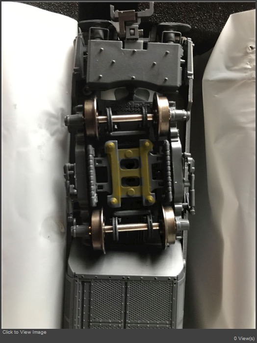

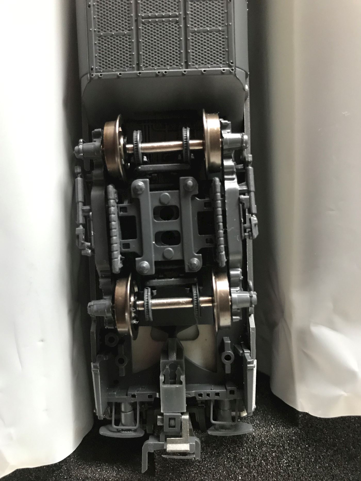

I think that the Panorama coach requires a different lighting strip than the other coaches.
Here are the photos from one of the recent SBB EC coaches (Bpm):
The older generation of models had the two pins similar to the ones that Roco had on the underside of their bogies.
These new ones have a slightly different appearance. According to the instructions, the coach models are already equipped with contact plates (DC). I don't think that these are wired to the coach interior. A cable probably has to be soldered to the contacts and to the lighting strip. The AC slider would have to be mounted on the underside of the bogie.
What you could do is to enquire with Eyro (CH), Huenerbein (DE) or other dealer to learn what they recommend for slider. I had a Flusterschleifer and axle contact from RailTop that I was considering mounting on an older LSM model.
I found photos of the bogies of the Panorama coach on Stummi Forum. You have to be signed in to view them
https://www.stummiforum....uerich-Debuet-Infos.html
The bogies are similar to the ones in the photos I posted above, except that the model comes with a third brake disc. It should still be possible to mount an AC slider on the bogie.

The photos are really helpful, my plan was to attach the slider one of the APM coaches and then use the 2 pole current conducting couplers from Viessmann.
I will take your advice and ask the dealer for advice (also check out the recommendations you shared). I emailed LS Models as well, so perhaps I might get some response from them too (though, I’ve emailed them before and never received a response - let’s hope this time I get one).
Just for interest, here is a brochure I found from 2017 that confirms the ability to attach a slider. While the design of the bogie may have changed since then, I would be surprised that this has changed.
https://www.trainsdepot....sbb_eurocity_coaches_pdf
Looking at your photo, I wonder if that part (highlighted in yellow) is removable. Looks like the Roco design underneath - unless it’s all one piece.
