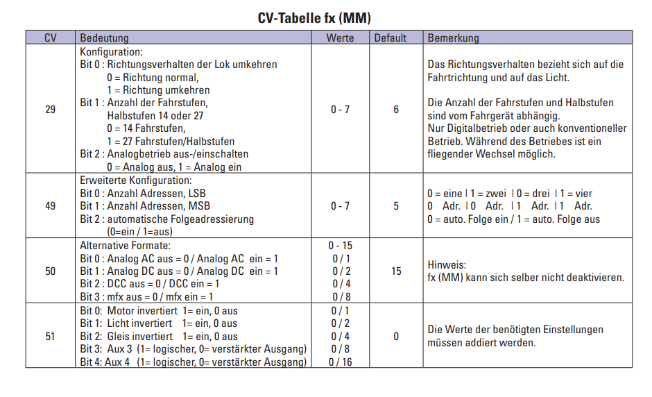

There remains the possibility that the MFX protocol has been blocked
CV 50 allows to select which protocols are allowed.
All protocols allowed --> CV50=15

Thanks for this suggestion. I tried this as well before, even by putting value 8, and also putting MS to only read MFX, but at this point the MS won't find the loco. The current value is 15, and MS (which has been reset to see all protocols) still only finds it as DCC.

All protocols are activated. I've even tried with MFX only. I've changed CV50 on the loco to 8 just to ensure that only MFX (And now also MM because the active protocol can't be removed) is activated on the loco.
I tried the loco again, still on same MM. Now I don't have any lights but I can still drive it and use two of the sound functions.
