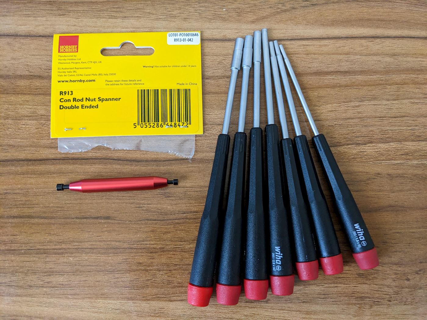

Full Wiha set 1.5,1.8,2.0,2.5,3.0,3.5,4.0 mm - very nice but a little pricey.
Also, available from a proper model railway company BigGrin , Hornby R913 Con Rod Spanner 2.0,2.5 mm - will fix that glaring gap in the Marklin tool set.ThumpUp

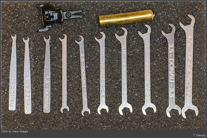

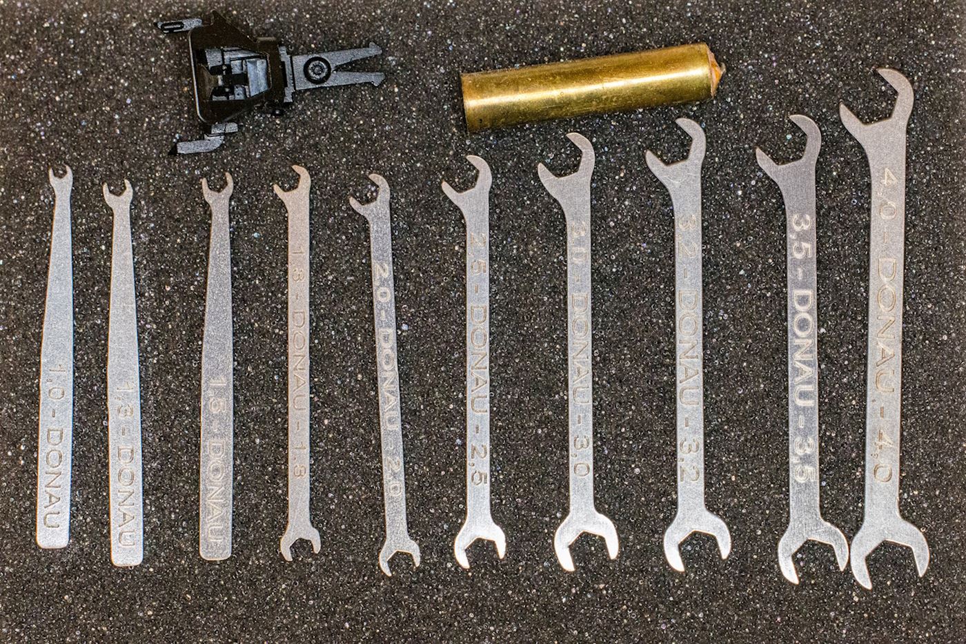

last year i bougt Micro Combination spanner/wrench set from Donau Elektronik, as a suplement to my Wiha set. mostly for easier acess to some nuts on wheels etc.
Coupler and smoke generator for size reference
