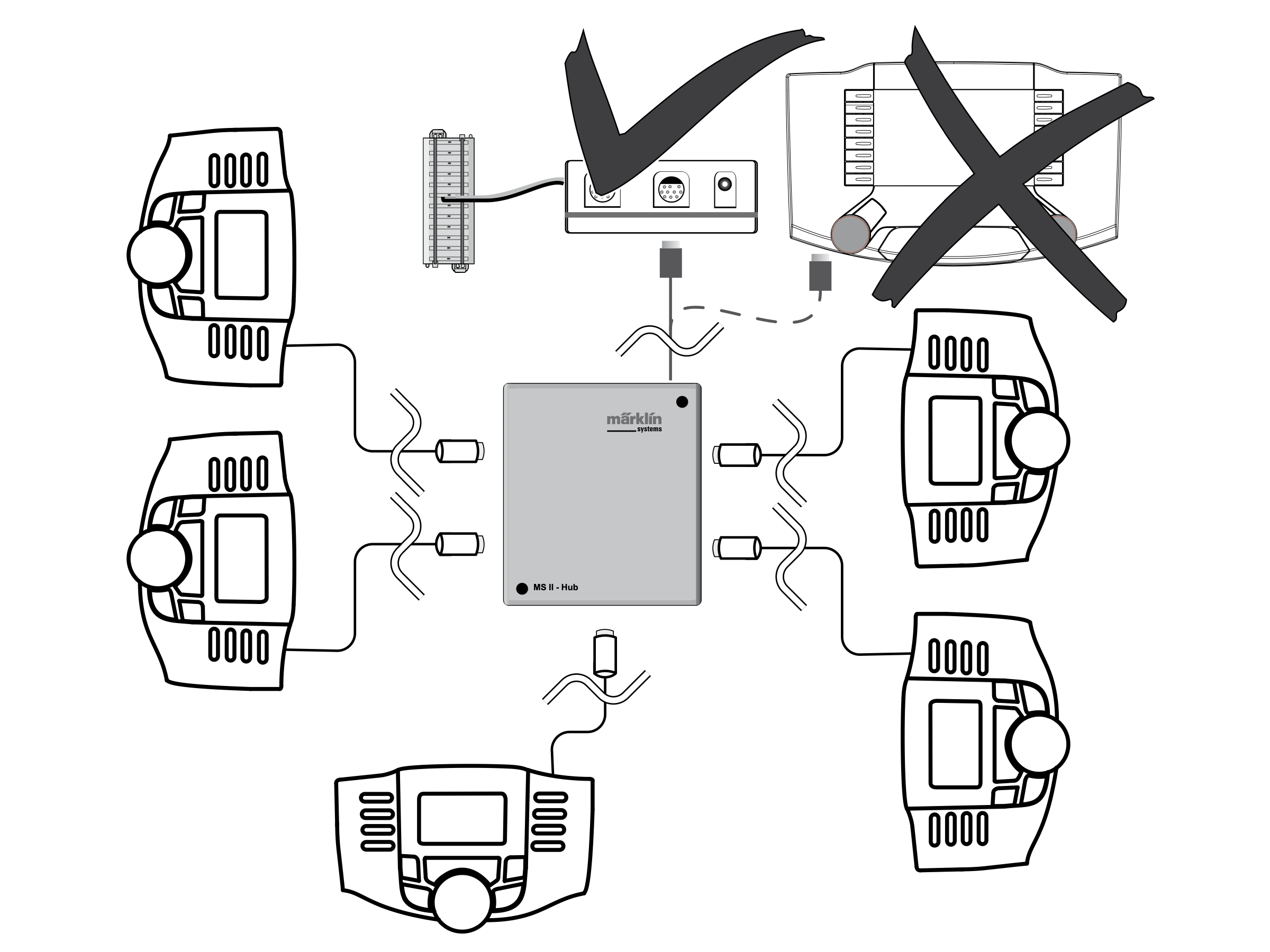

There was a hub for Mobile Station 2
Called MS II Hub (60122)
used to connect more than two MS2 to the digital box.
As it is a box with a cable, it could be used as a cable extension.
I do not know the cable length, and it seems to not be produced anymore,
but certainly available in shops.
Hope this helps
Best Regards
Joël
