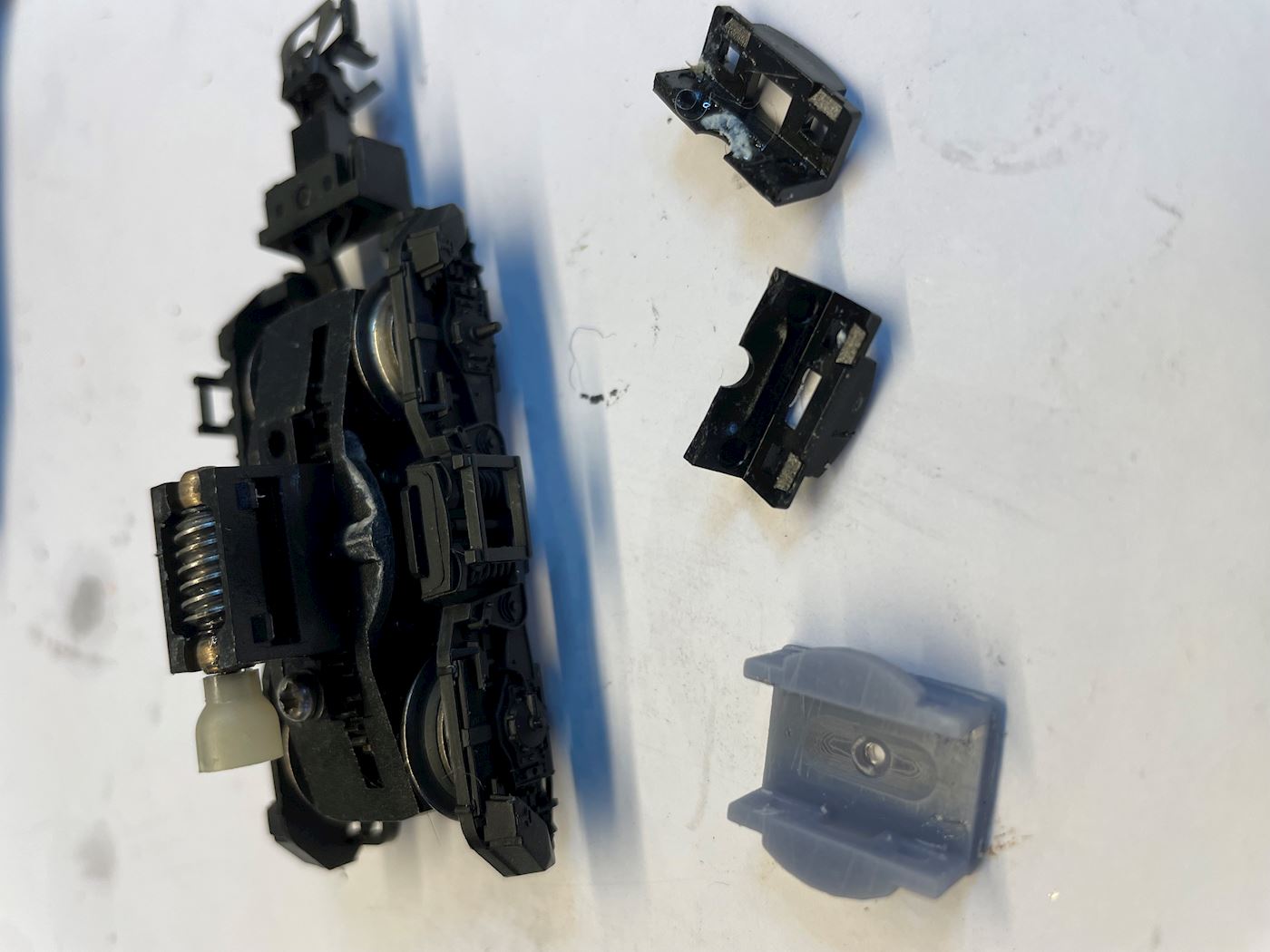

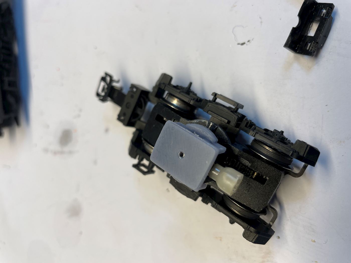

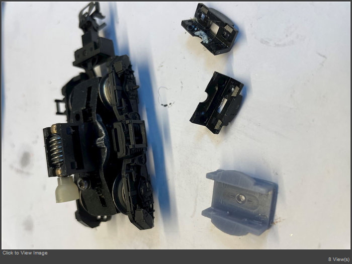

Still working on this loco. Have cleaned the gears,wheels pickup etc. but durig dismantling I broke the top cover of the worm house. Very happy to have modelled and 3D printed replacements. Looking forward to try loco again.
Thor Inge
