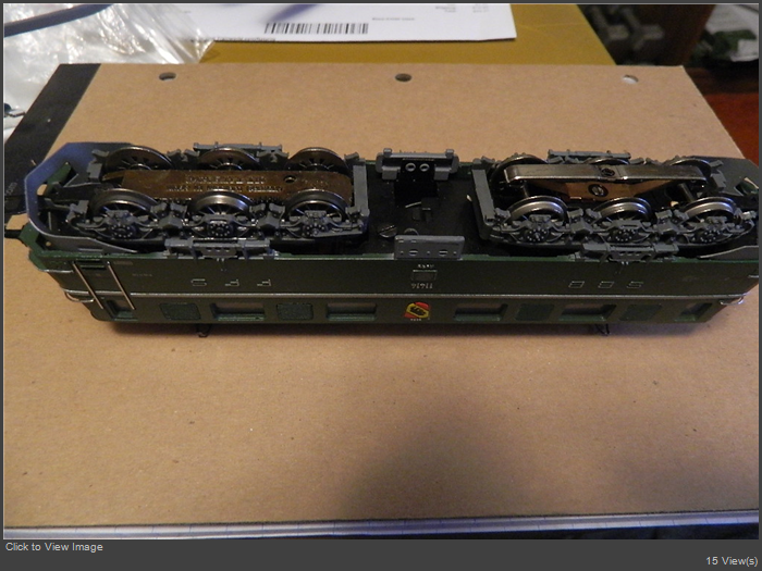

Loco 11414.JPG11414 Loco.JPGI recently bought a used locomotive 11414. It is prone to leaving the tracks, particularly at switches. At close inspections it looks like the wheels might have a smaller lip than other locomotives. Has anyone else had this problem?
Here are two more angles of the loco.
I will test more regarding which direction it runs better and comment again.
The loco derails at switches going in each direction. My other locos don't derail at the switches so it is not the switches fault. Perplexed.
The bogies move easily, no obstruction from wires.

Could it be your missing some or all of the 4 rubber traction tyres. Can we please have a picture of the underside of your loco.

Ok here is the picture of the loco in question from Chuck Burkert:
[img]UserPostedImage[/img]
I must say it looks like all traction tyres are intact. We need to look at the rear of the loco & see if there is any up & down play in the three rear axles.
This kind of wear can occur from heavy use especially when the loco goes in one direction all the time. The loco can adopt a lopsided look as if it has a puncture.

First thing that I noted in the photo is that there seems to be oil seepage on the bottom of the motor block.
I see what appears to be normal wear on the traction tires.
