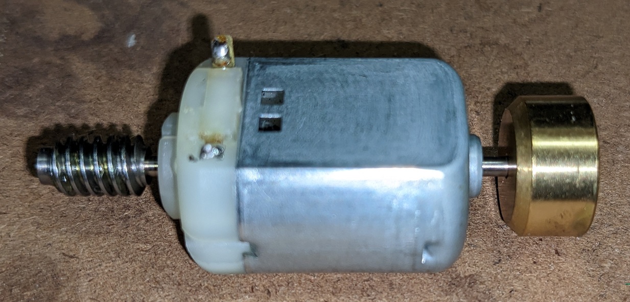

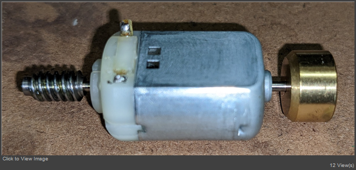

Hi Bill,
The motor is just a simple can motor, 2" or 50 mm long.
The decoder normally just has motor and light outputs but it seems some people have squeezed an extra function or two out of it.
