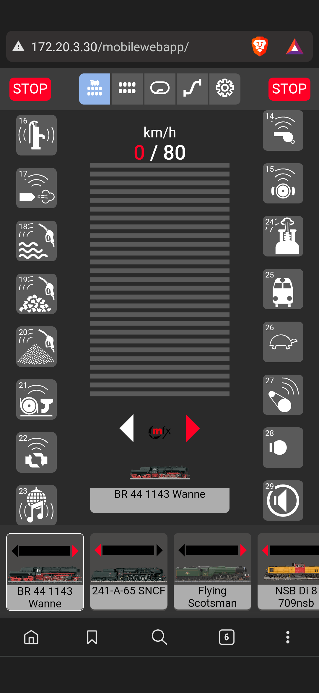

one thing I notice is the big changes to the web interface, for both desktops and mobile phones......
Here is an auto translated change log:

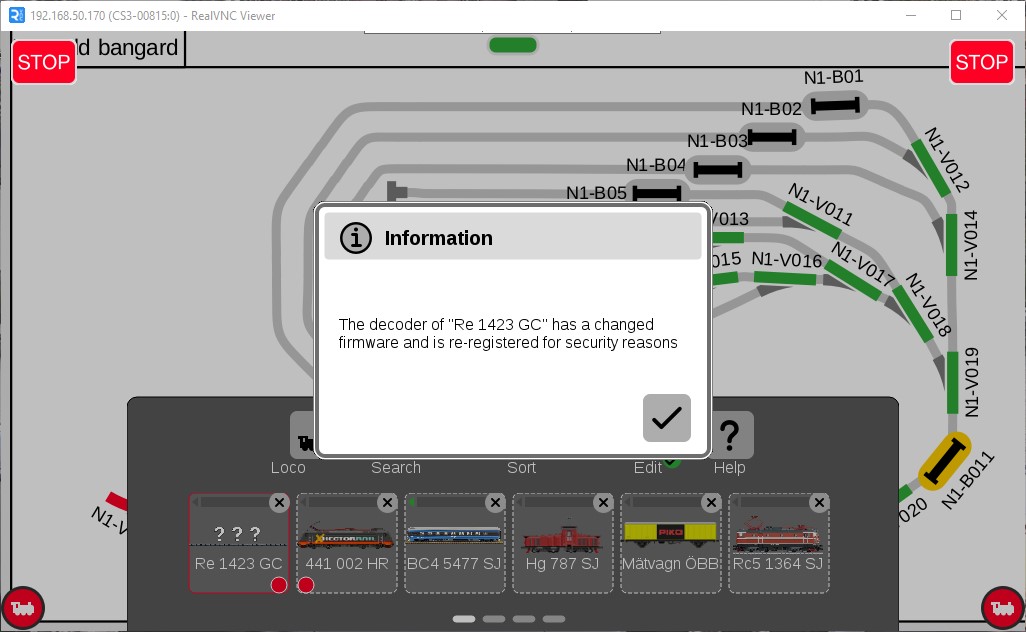

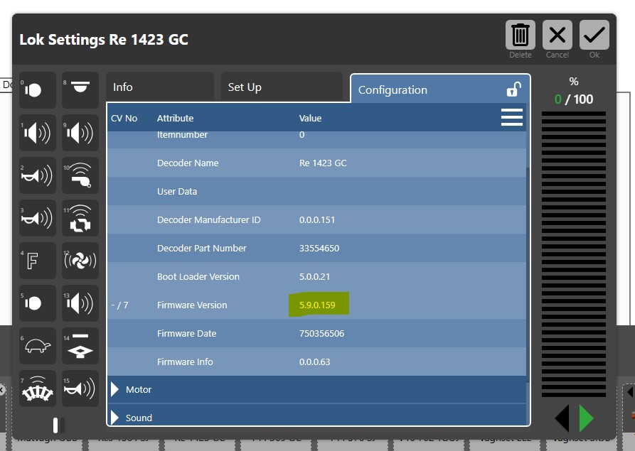

Not funny with ESU 5 decoders Angry
Did they not try reading out CV with other producers decoder...
http://www.modelltag.se/...users/20231201200629.mp4
it re-registers the locomotive and puts the CS3 in stop mode.
thanks 2 users liked this useful post by jonas_sthlm

I noticed that all locomotives are reregistering and when that is complete the cs3 goes automatically to stop mode. on some locomotives, the CS3 claims it needs to reregister because of a firmware update, even when no update has been done.
and I noticed a couple of bugs in the new web interface.
One is incorrect voltage and temperature reporting from my booster (60175).
voltage is approximately half and temperature is missing. On the cs3 everything is fine.
another is a scaling issue if you make the pc browser window too small it becomes very hard to adjust the locomotive speed, especially down.
any anyone else? other issues?
the new web interface on phones is quite nice.

It is possible to access the locomotive with the ESU decoder through the web interface
But also bug, everything stop on the second locomotive...

I did an online forced update, and my CS3 still reregister all mfx locomotives, but at least it does not go into stop mode afterwards anymore.
tested one locomotive with ESU lok sound 4 and it worked fine, even accessing function mapping.

Comment, for those more familiar with using a browser to connect to the CS3.
Prior to 2.5.x the end point would offer a Settings/Tools section from where you might see
- see ChangeLog
- take a ScreenShot
- upload/manage Loco images
- select CONTROL to go to the web view of the CS3 app
with 2.5.x the endpoint now takes you directly to the CS3 Control screen - i.e. a web browser view similar to what you see on the CS2 itself but (unlike the VNC) it has its own session.
For those wishing to review the Change Log or Take a screenshot these are now imbedded under the System settings themselves
Change log is under information Section
New Sections exist for ...
Offline clapcott
#32 Posted : 03 December 2023 08:03:58(UTC)
clapcott
Joined: 12/12/2005(UTC)
Posts: 2,464
One of the aspects of the CS3 and the earlier browser Control/CS3App was the overlaying of all aspects on the same screen.
Sure, with the Control/App you could bring up multiple windows which are setup for layout OR Locos OR accessories.
With the new web browser comes distinct endpoints for Locos, events, etc.
These may be found/navigated to via the system setting panels ...
or you can type/bookmark directly
Locomotives http://192.168.1.xxx/locos
Events http://192.168.1.xxx/automatics
Accessories http://192.168.1.xxx/mags

Switch off the M4 function in ESU 5, then it's possible to read DCC CV value without getting firmware update massage...

Yesterday I tested with the previously registered locomotives and some mfx locos reregistered and others didn't need to do it and worked well from the start.
I must say that I needed to do 1 shutdown and a boot before it starts to reregister because at first (before the reboot) they simply didn't work. The simple reboot didn't work.
Another strange thing I experienced after the shutdown and "unplug - wait 30 seconds - plug" the power supply cord to the mains, was that the CS3+ didn't wake up. I unplugged it
again and waited several minutes with it unplugged before plug it again, and then yes, it booted normally. I think this isn't related to the update as it looks like an hardware issue.

The update 2.5.1 went well, but I also have the issue of Re-registering with M4 decoders... Each time I try to edit the engine on the CS3+, the it re-register the engine so no edit is possible... this is very annoying... the only way around is to change the decoder CVs to only allow DCC...
Is it a wrong update of the CS3 or is it the new way of this update ? Any other way around this ?

Use the WebApp to change decoders settings until M fix the issue.

I too have discovered that my update is requiring all my mfx locomotives to be re-registered. The problem is that I had changed all of my long whistles from on/off to timed and they seem to be back to on/off. Not sure yet if any other settings have changed.
thanks 3 users liked this useful post by rhfil
