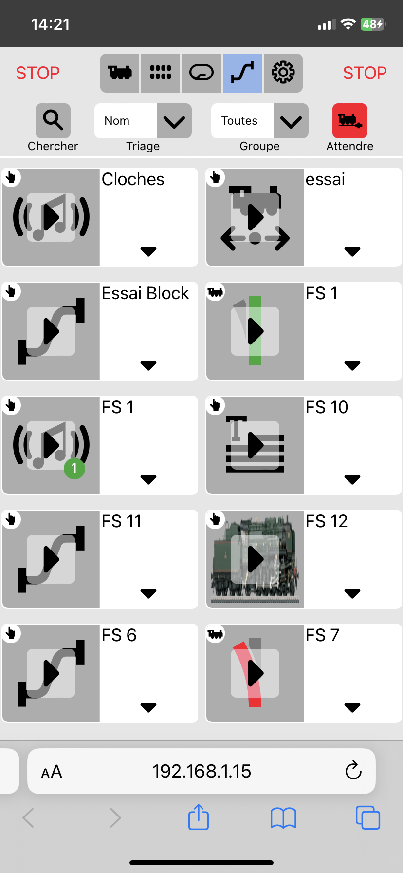

#57 Posted : 20 December 2023 10:40:05(UTC)
Posts: 3,731
Hi rhfil
A long time ago I signed up for a VCN to connect with my CS3+ but accidentally signed up for the free 90 day trial. It was way too buggy for me. I normally bring my iPad to train shows and connect with the club CS3+ to operate loco functions and stop the operation quickly when there is a problem. I would like to try the VCN connection again but does anyone have the proper procedure to do so through the CS3+? Is there a video anyplace showing the procedure?
I may be wrong of course but I believe the connection using VNC Viewer (freeware) is not possible anymore.
Instead, Märklin has rewritten the web interface two folds: one for computers and one for small screen devices (smartphones)
How it works?
- the CS3 must be connected to a "Box" or a WiFi router BEFORE power-on
- simply copy the IP address displayed in the CS3 (System/CS3/IP) onto your smartphone browser into the address field
You get this first screen
Selecting the + key allows you to import all the locos like this
Selecting the loco you wish you create your favorite locos list (Maximum 20 locos
You may - of course come back and remove locos from the favorite list and add new one using the symbol bottom left of the horizontal favorite list
Selecting a loco, you get access to max 32 fonction (vertical sliding)
You get access to the track layout
and to events
Voilà, this is just great BUT not on tablets (I tried with my old iPad and it didn't work

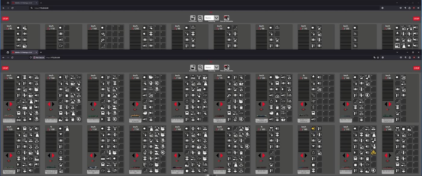

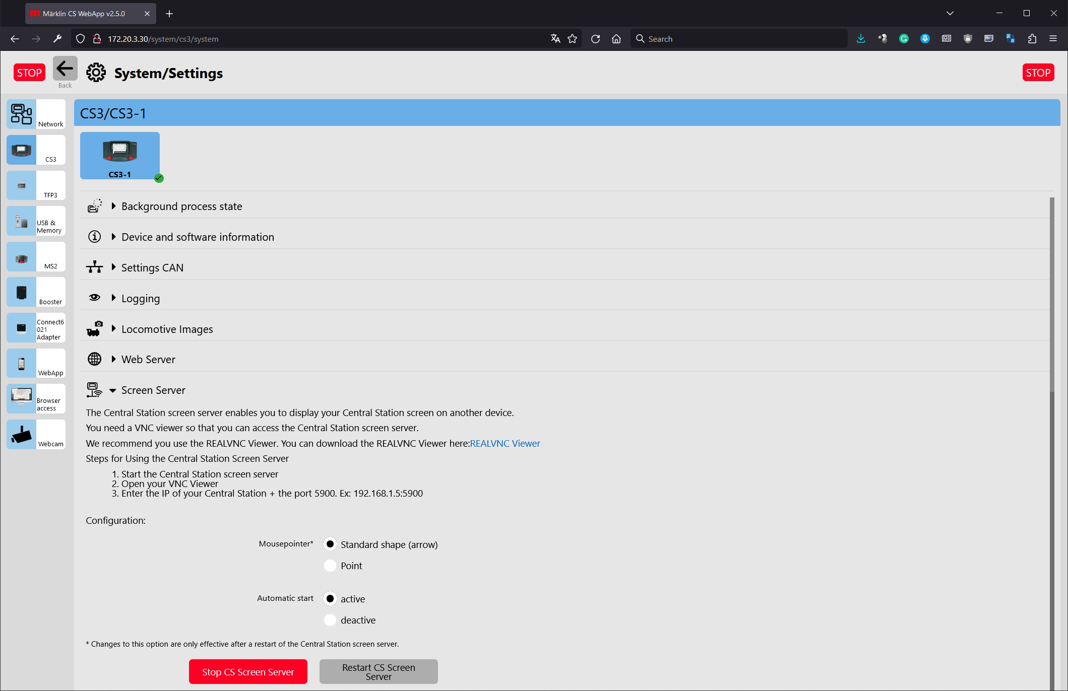

VNC still works fine. and should not be confused with the web interface, as it is a different "tool"
VNC Viewer is a remote control of the CS3 screen/"desktop". (same with old and the new 2.5 CS3 software)
The web interface is independent of the CS3 screen. It was this with the old version and still is with the new.
with both the new and old web interface you can open several windows on your PC at the same time, and have different content in them all.
to be able to use VNC you need to activate the Screen Server using the web interface:
it's a good description on that page.
Have not tried it, but VNC lite should be free. https://www.realvnc.com/en/connect/plan/lite/(I'm using an older free VNC viewer version)
More detailed instructions can be found on page 40, in the manual. https://www.maerklin.de/de/service/downloads/cs3-updates
https://streaming.maerklin.de/public-media/anleitungen/CS3-Kurzanleitung_V25_DE.pdf
So far there is only a German manual, for the latest CS3 2.5 software
One interesting web interface view mode that has been updated is the "expanded" locomotive list, which can also be used to control locomotives.
(the higher resolution you have on your pc the more locomotives you can display, or alternatively use the browser zoom)

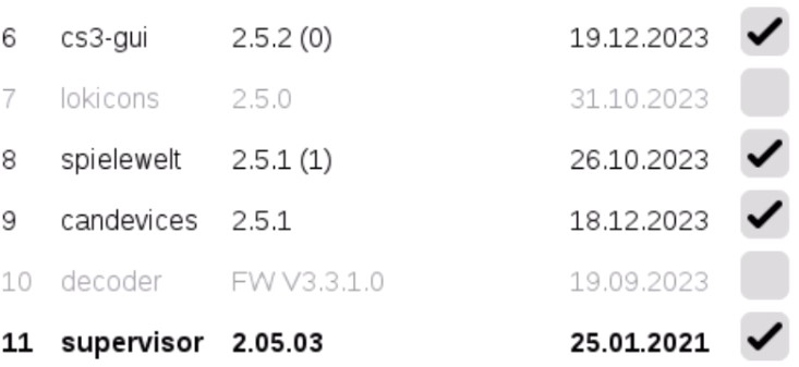

Tried for few days, does not solve the problem with ESU but they working on that too ThumpUp
Previous files versions
cs3-gui 2.5.1(0) 31.10.2023
spielewelt 2.5.0(1) 26.10.2023
candevices 2.4.1a 20.06.2023
supervisor 2.05.02 20.04.2017
some issues solved for me
the device is not freezing when attaching usb stick
it doesn't go in Stop mode after some minute when exit decoder configuration
needed clean the history of my Edge browser on the mobile after 2.5.2 upgrade otherwise only black page
Edited by user 03 January 2024 16:06:31(UTC)  | Reason: Not specified

Has anyone get the link for 2.6.0 version.
#87 Posted : 25 January 2024 23:18:33(UTC)
Posts: 3,731
For those who have issues with the latest CS3 version 2.5.1(0) Märklin allows this step back.
Note This may be needed for those with MFX locos without Märklin decoders (Not my case, V2.5.1(0) works fine for me)
I just saw that Märklin allows to load the previous version (v2.4.1) Here https://streaming.maerkl...te_v2.41.0_ms2-4.1.btrfs
#88 Posted : 26 January 2024 01:22:00(UTC)
Posts: 8,727
There is no 2.6.0 version available.
Offline jonas_sthlm
#89 Posted : 26 January 2024 08:34:31(UTC)
jonas_sthlm
Joined: 12/10/2008(UTC)
Posts: 1,099
I did get the link for 2.5.2 before from M but the rumors say that it should be a new version 2.6.0 out.

Few days ago I connected the CS3+ to the Internet and it didn't get any new update, so it is still in 2.5.1.
Is the 2.5.2 available?
Miguel
Mostly Märklin H0.
Offline jonas_sthlm
#91 Posted : 26 January 2024 13:40:15(UTC)
jonas_sthlm
Posts: 1,099
Yes, I received link to M cloud server with 2.5.2 but it didn't fix the ESU issue.
