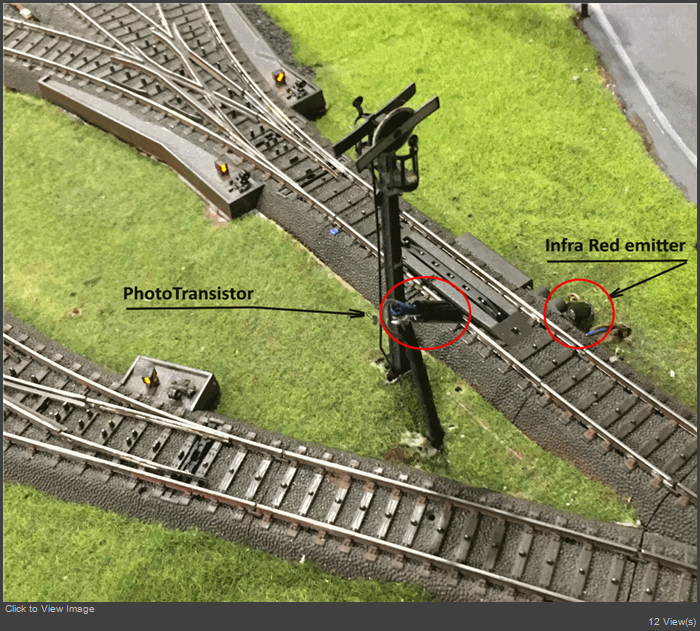

@Matison: I use Märklin older generation signals (7039, 7040, 7041, 7042, 7043) and they work very well in digital.
I started using older M83 (6083) and now newer (60832) without any problems
To implement those signals in a modern (more detailled) scenery I have embedded their large solenoid base into the layout's plywood base to look like this
Here is a humping signal
The other thing I did was to replace the small bulbs (60000) by their equivalent in LEDs. They can be found on ebay (Germany for instance) looking for "MS4 LED".They are not overheating the signals and bleaching the small colour lenses and the current is only a small fraction of a regular bulb. Because they never die is a relief because replacing them calls for removing the signal temporarily
So the station looks like this now
How to embed a Märklin signal?
- Using a vibrating saw, cut a rectangle hole (the size of the signal you want to drop down
- cut multiple carton rectangles, some with a rectangular hole in them to give more depth to the signal mechanism, and one normal to support the signal
- glue them together and use Märklin rail screws to increase strength
- cut a vertical hole for the signal wires to go down
and it looks like this
