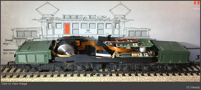

#4 Posted : 03 August 2023 18:39:13(UTC)
Posts: 3,683
Hi Marco
No expert here, sorry.
I don't have this loco but it was released in 2006 with a C-Sine motor (not a SDS - Soft Drive Sinus).
If, inside, it looks like this it is problematic to repair
So I believe it is an early for of Sinus motor where a mSD3 cannot be used for repair (only SDCµS locos with 21 MTC plug-in decoder can)
