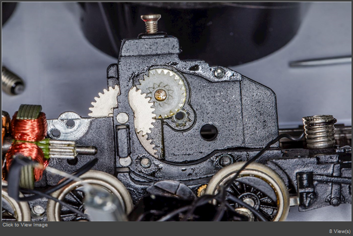

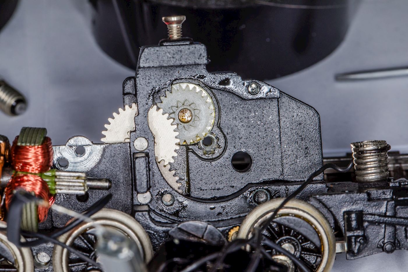

if it helps here are pictures of my 3148. Had no issues with that locomotive and the 60943. Was the 60943 set brand new?
Thanks, I'll open my loco up and see if there is anything different in the frame... The magnet feels to fit in good though.
